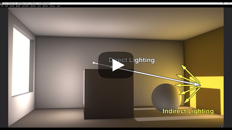

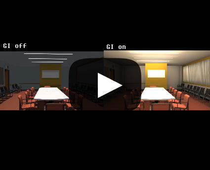

- Visual Aspect:In addition to direct lighting there are indirect sources of illumination resulting from light beam bounces from nearby surfaces. Indirect lighting can enhance the realism and beauty of a scene especially in dark unlit areas. The following video demonstrates a project which contains a directional light and IBL (Image Based Lighting). When GI is on, the shaded areas in the entire scene lights up due to bounce lighting, consequently one can notice more details in areas that would otherwise be too dark too see.

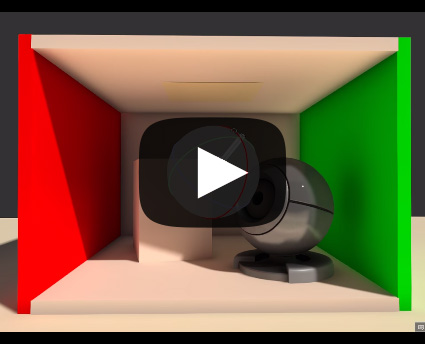

* GI is most effective in scenes with many large surfaces which increases the number of light bounces. For example: indoor scenes or Cornell box setups. - Creative Aspect: In the past, indirect light must be "faked" by adding more complementary lights to increase the brightness of shaded areas. With GI, you are free from this tedious work by using just one directional light to brighten the entire space.

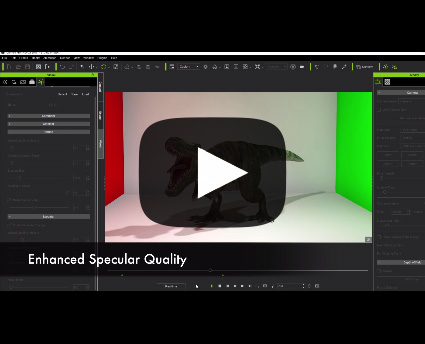

www.geforce.com/hardware/technology/vxgi/technology - The Specular parameters are what gives us blurry and mirror like reflections from true 3d objects (to certain extent). This is based on voxel information being reflected from one object to the other so the quality of the reflection is only as good as the voxel density resolution.
