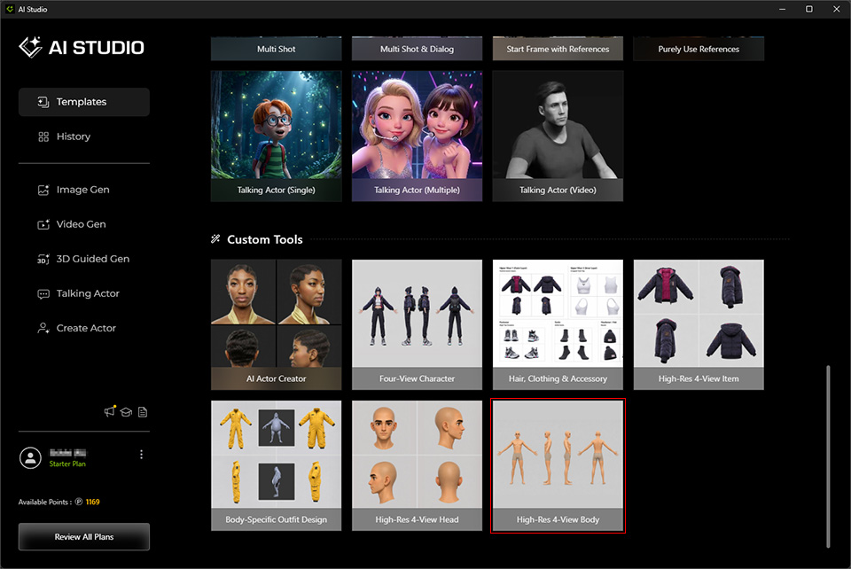

High-Res 4-View Body Template (New for v5.2)
In AI Studio, go to Templates > Custom Tools to explore all 6 template tools. Click the High-Res 4-View Body template to open it.

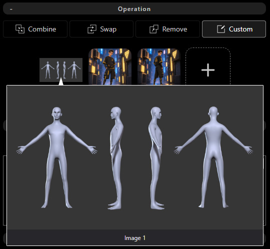

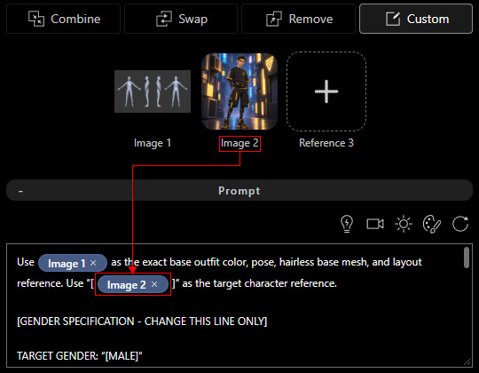

Replace Reference Images

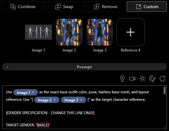

  1. After the template opens, AI Studio automatically goes to Image Gen > Edit > Custom (under the Operation section).
  2. Keep Image 1 unchanged, as it defines the four viewing angles for the AI.

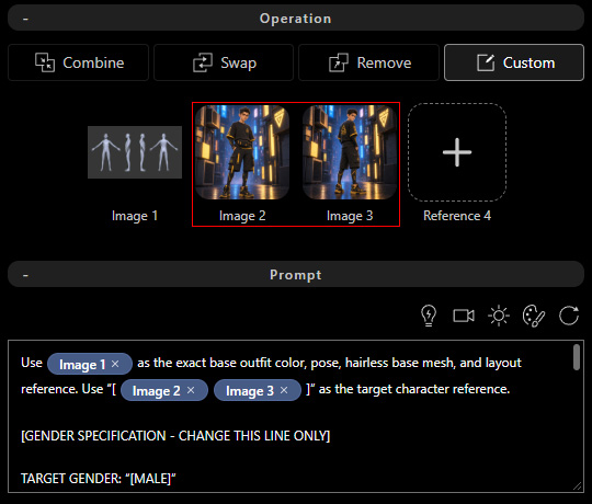

  3. Replace Image 2 and Image 3 with images of the character you want to generate. You can remove either image, but at least one reference image is required.
    • The Image 1 should ideally be a front-facing or near-front-facing photo with a pose of clearly visible limbs.
    • You can use one or multiple reference images to provide the character's appearance. Ensure the images depict the same character for consistent results.
Update the Prompt

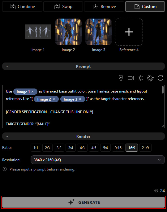

  1. The prompt is preconfigured. Do not modify its content except for the image references in the first paragraph and [GENDER SPECIFICATION - CHANGE THIS LINE ONLY] > TARGET GENDER section. Make sure the image references match the number of reference images used above.
    • One reference image:
      User "[ Image 2 ]" as the target character reference.
    • Two reference images:
      User "[ Image 2 Image 3 ]" as the target character reference.
    • For additional reference images, follow the same pattern and include all corresponding image slots.
    • Set Target Gender to match the character's gender in the reference images.

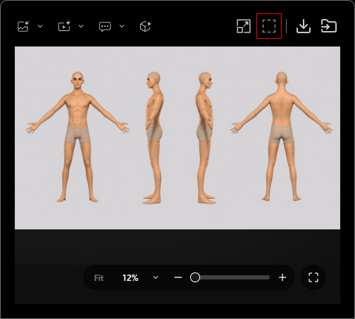

  2. Click GENERATE to generate a four-view character's Body Only image. If you are not satisfied with the result, click GENERATE again to generate another image.

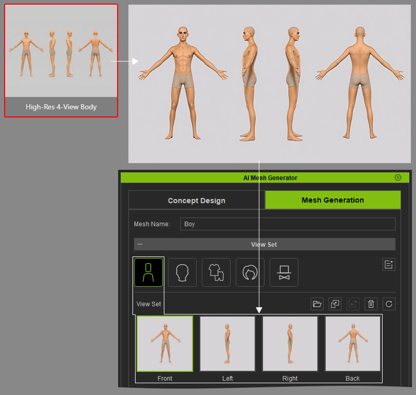

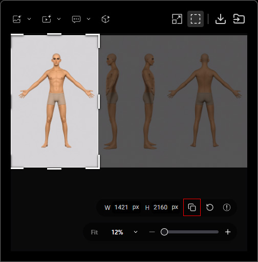

Copy Each View
  1. Activate the Select tool.

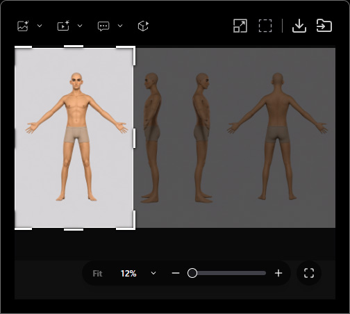

  2. Select one view from the generated four-view image.
  3. Click Copy to Clipboard below the selection, or press Ctrl + C, to copy the selected view to the system clipboard.

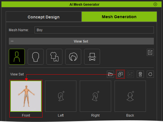

Import Views into AI Mesh Generator

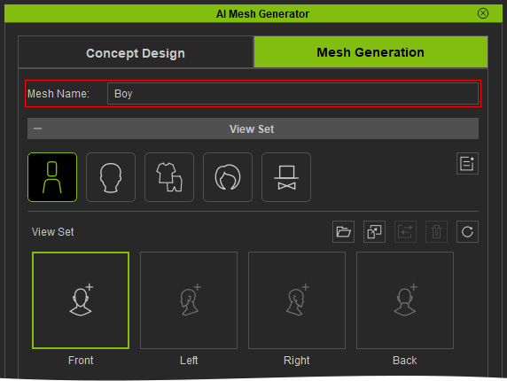

  1. Open AI Mesh Generator and go to the Mesh Generation page. Enter the Mesh Name.
  2. Make sure that the Mesh Type setting matches the one copied in the AI Studio. In this example, select Character.

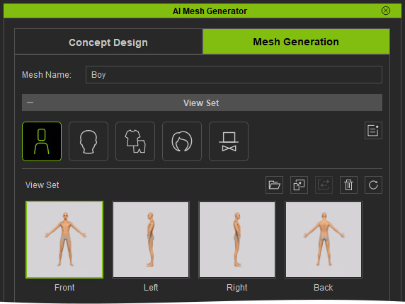

  3. Under View Set, select the slot corresponding to the one in step 8 (Front, Left, Right, or Back).
  4. Click Paste image from clipboard, or press Ctrl + V, to paste the copied view.
  5. Repeat for the remaining views. A Front view is required; the other views are optional.
