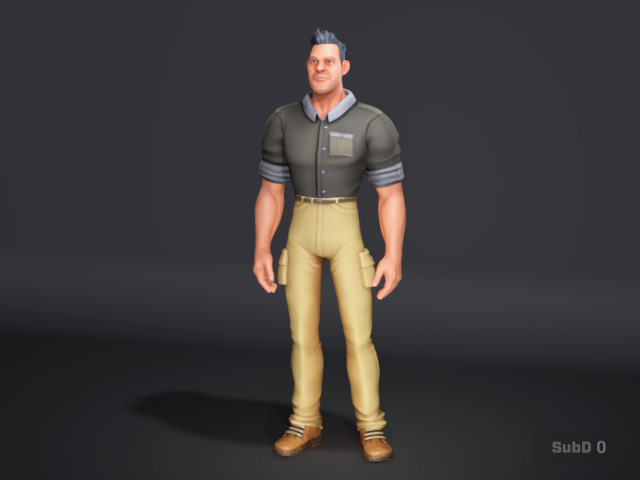

  1. Create a new project and create a character with clothes.

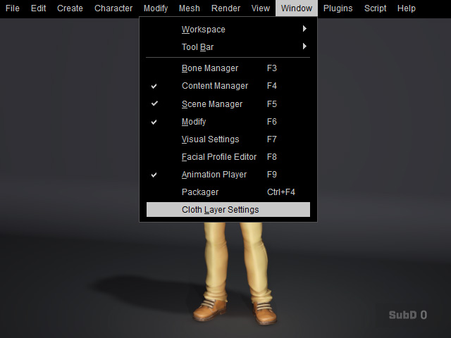

  2. Execute Windows >> Cloth Layer Settings command to launch the panel.

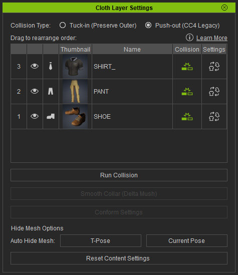

    Cloth Layer Settings panel will appear:

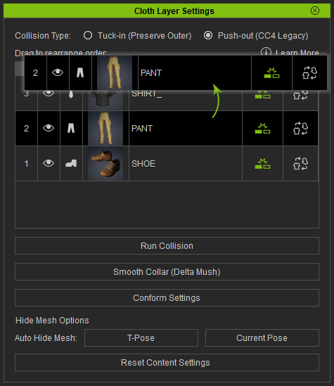

  3. Rearrange the layer order number of the item by dragging and dropping.

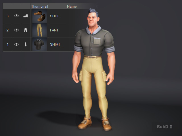

    The layer will be re-ordered.

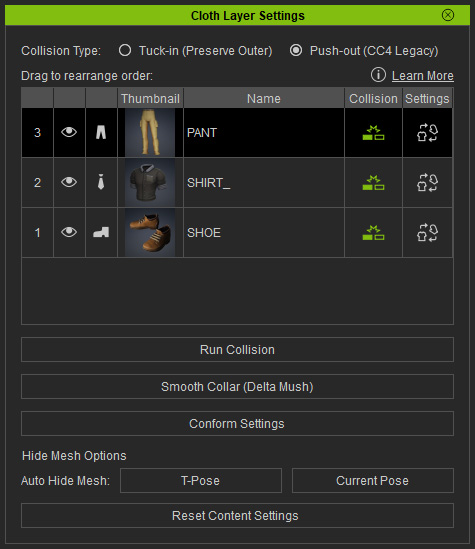

    The penetration issue appears.
  4. Click the Run Collision button to see the collision result.
