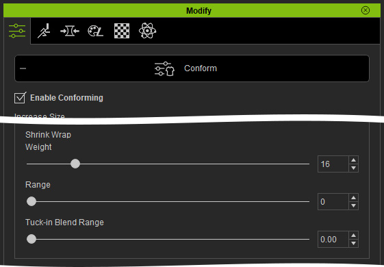

Character Creator 5.2 provides two Collision Types to prevent mesh penetration between clothing and the character: Tuck In and Pull Out. In Tuck-in mode, use Shrink Wrap Settings to control how the entire garment shrinks around overlapping clothing.
  • Weight: Controls the overall shrink strength of the garment, excluding areas where clothing overlaps.

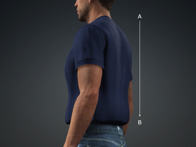

  • Range: Defines the shrink area from the farthest point (A) to the nearest point (B) relative to the overlapping area.
  • Notice that the Weight and Range must be used together. If either value is set to zero, the shrink effect is disabled.

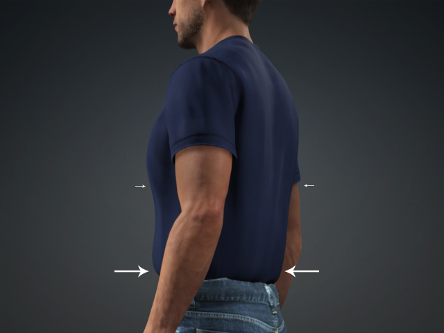

    Weight = 40
    Range = 0

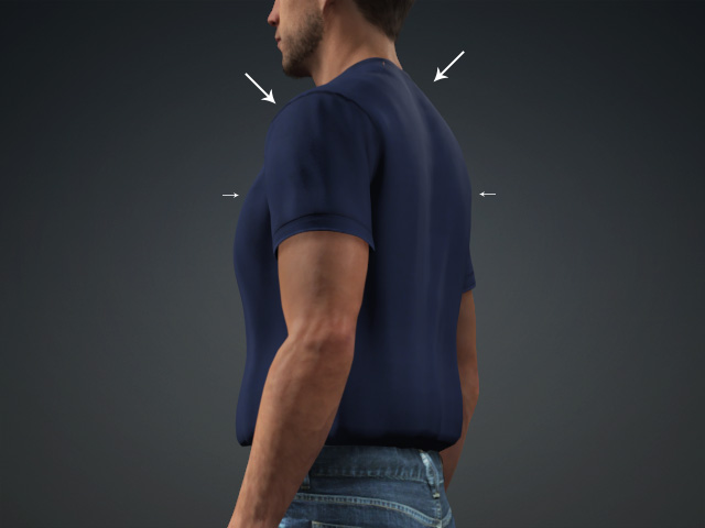

    Weight = 40
    Range = 100

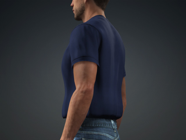

    Weight = 40
    Range = 0
    Tuck-in Blend Range = 0

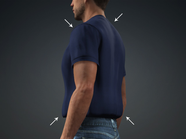

    Weight = 40
    Range = 200
    Tuck-in Blend Range = 10.00
