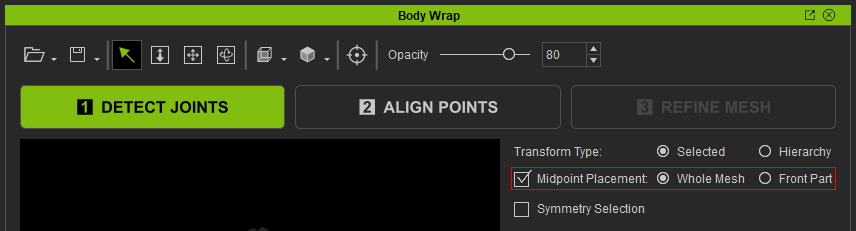

AccuRIG feature provides Midpoint Placement feature to auto-detect the mesh volume and position the joint in its midst (between the front and back surfaces).
  1. In the example, the outlined guides are offset from the mesh volume.
  2. Activate the Midpoint Placement checkbox and choose the Whole Mesh radio button.

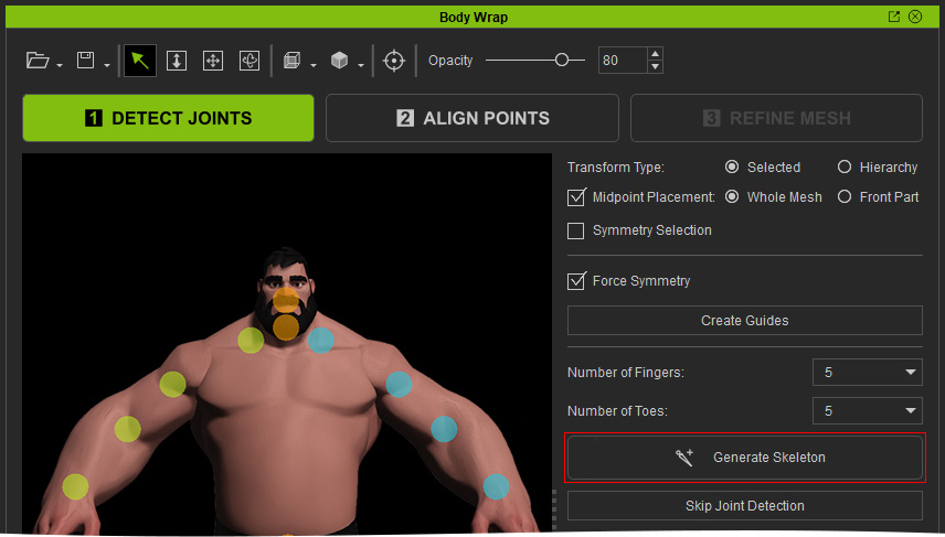

  8. Click the Generate Skeleton button to create bones from the guides.
    You will see the body skeleton and the hand guides are generated.
