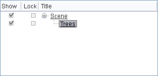

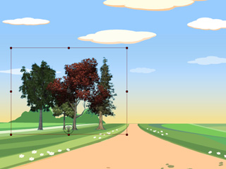

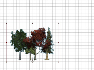

  2. Load a media file (an image in this example) and convert it into a new Prop.
    Source Image
    Loaded into CrazyTalk Animator

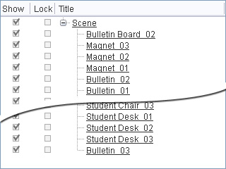

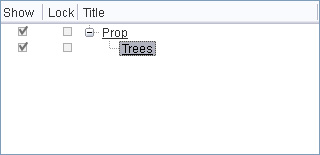

    The newly-added props are all under the Prop item in the Scene Manager.

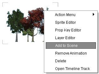

  3. Right-click on the prop you want to add to the scene. In the right-click menu, select the Add to Scene feature.
  4. Look at the Scene Manager, you may see that the prop is now moved under the Scene item.

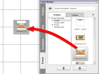

After you apply a scene template from the library, then you may extract the props within the scene. The props will not be replaced during the next scene replacement.

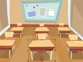

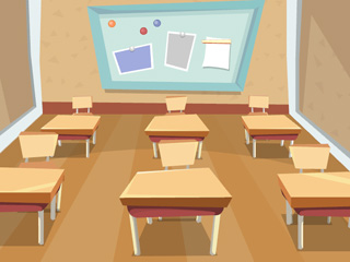

  1. Apply a scene template from the library.
  2. In the scene manager, you may see all the props within the new scene.

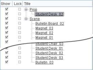

  3. Select the desired prop and right-click on it.
  4. Choose the Convert to Prop command. The prop will be moved under the Prop item.
  5. Apply another scene template. This prop will not be replaced while all the other props under the Scene will be replaced.

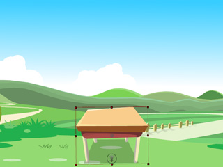

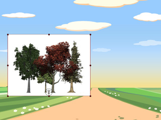

It is highly recommended for you to load media with masks (alpha channel) so that the when the media files are loaded into CrazyTalk Animator then the unnecessary parts are filtered out. The supported file formats (with masks) are *.png, *.tga (32 bits), *.bmp (32 bits), *.gif, *.popVideo and *.iWidget.
Without Mask
With Mask
