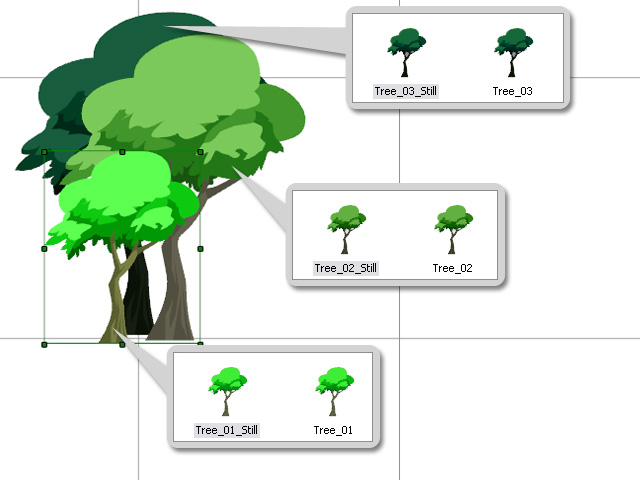

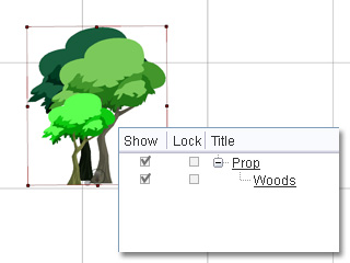

A prop named "Woods" in the Stage Mode

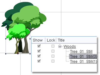

Three sprites composite the "Woods" prop in
the Composer Mode
  • Each "Tree" contains one or more elements (Using Sprite Editor)
  • With these elements you may set keys to create an appearance-changing animation.
