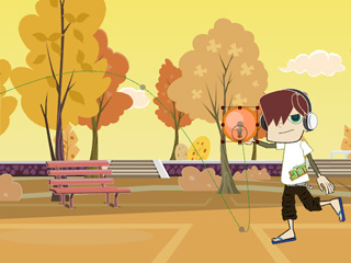

In CrazyTalk Animator, the moving path form of an object (character or prop) can only be a curve or a straight line. If you save the object into the content library, then you may move the object with mixed path forms by using the Visible/Invisible feature.

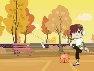

  1. If you want the character to kick the ball that is dropped from his hand, then the path of the ball can be like this:
    The path from the hand to the ground is not vertical.
  2. Apply the same prop from the Content Manager, it will become the second prop in the project.

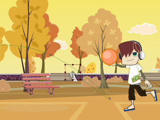

  3. Have the first prop move along the vertical straight path.

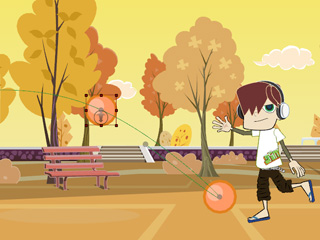

  4. Have the second prop move along the curve path.

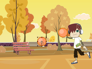

  5. Go to the start frame, hide the second prop by clicking the Visible/Invisible button. The button will change and the second prop will now be hidden.
  6. Go to the frame where the two props superimpose each other. Click the Visible/Invisible button again to show the second prop. Remember to select the first prop and hide it with the same method.

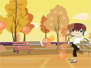

  7. Play back to see the result.
