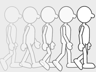

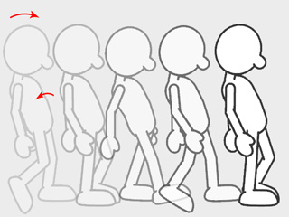

Given a 3D motion on a character before the motion is modified with a 3D Motion Layer key.

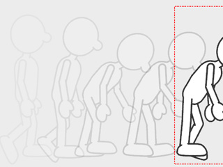

The motion will be modified after being affected by a 3D Motion Layer key.

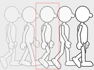

  2. Go to the middle time frame of this motion.
  3. In the 3D Motion Layer track, add a motion layer key to any desired time frame.

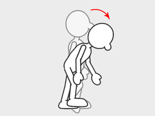

  4. The key will influence the entire motion clip unless another key is added afterward.

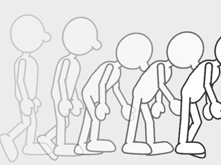

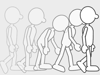

In the last example, the character bends from the middle of the motion up until the end of the clip. Please follow the steps below to reset its pose at the end of the motion:

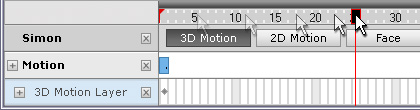

  1. Go to the end time frame of the motion.
  2. In the 3D Motion Key Editor, click the Default button to set initial keys to all the virtual bones.
  3. The character will gradually return to the up straight pose at the end of the motion.
