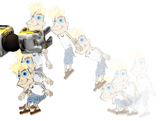

  2. Use the Body Puppet Editor to record and produce a motion clip.

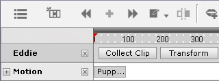

  4. Click the character's Motion main track button. You will see the clip in the track.

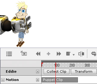

  5. Drag the play head to the time frame where you need to break the clip up into new half clips.

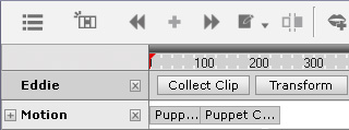

  6. Click the Break button on the Timeline toolbar.
  7. The clip will be divided into two halves.

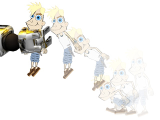

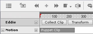

  8. Select the second one and delete it.
  9. Play back the project and the character's motion will stop at the end of the trimmed clip.
