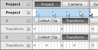

Given a project in which the objects are all animated by keys.
Press F3 to open the timeline. Click the
Track List button and select Project from the menu.
Click the Project button to show the track.
Drag in the track to make a range for deletion.
Click the
Delete Frame button.
You will then be prompted to choose the deleting method.

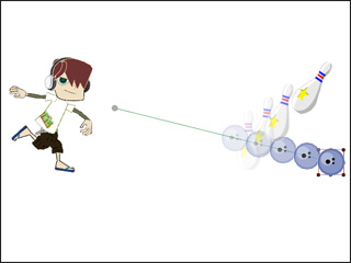

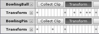

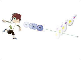

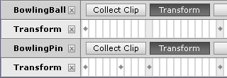

Given a project with two props animated by keys. The pin moves away
before the ball hits it.

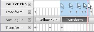

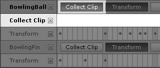

Open the Timeline (F3). Show the Transform tracks for the ball and the pin.
Click the Collect Clip button of the ball to show the

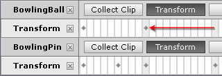

track.
Click the
You will then be prompted to decide the deleting method.
Delete Data: Delete only the clips, keys and switches within this range.
Delete Frame: Delete keys, switches and the frames within this range.

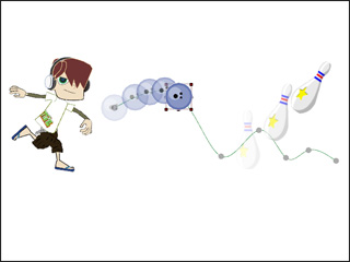

If you Delete Data, the data within the range will be removed. The previous data after the range will
stay where it is.
If you Delete Frame, the data and frames within the range will be removed. The previous data after the range will be advanced.
