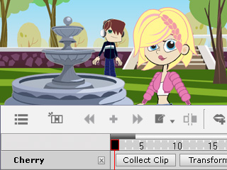

  3. Press the Object-related Track button.

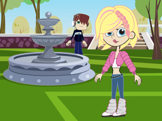

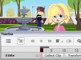

  4. Pick a character in the working area. The timeline will then only show the name of the character and its track buttons.

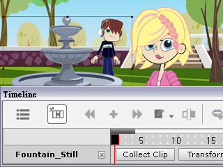

  5. Pick a prop in the working area and the timeline will hide the character's track, and only show the name of the prop and its track buttons.

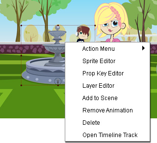

  3. Make sure that the Object-related Track button is not pressed down.

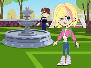

  4. Right-click on another item in the working area to display the right-click menu.

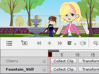

  5. Select the Open Timeline Track in the menu.
  6. This item will then be shown in parallel with the character.

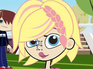

  2. Pick another character. Click the Sprite Editor button
    The Sprite Editor displays.
  3. Click on the upper body of the character.

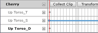

  4. You will see that the timeline will automatically show the Up Torso_T, Up Torso_S and Up Torso_D.
