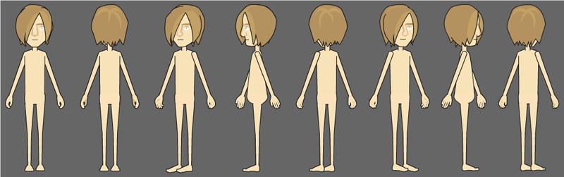

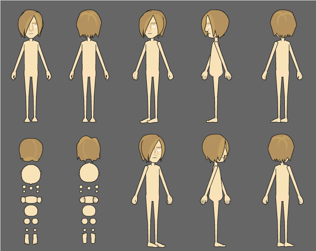

CrazyTalk Animator 2's G2 characters have the ability to perform 3D motions. In order for a G2 character to do that, it needs 10 different angles. Please refer to the G2 Character with 8 Angles page to observe the 8 separate angle profiles.

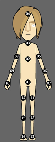

Your character in Flash should look like the below illustration:
Each CrazyTalk Animator 2 G2 character is composed of 16 sprites or body parts. The sprites are:
