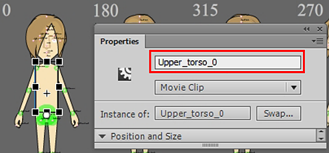

When you click on the sprite in the stage, you will see the properties.
Please give the movie clip a stage (instance) name according to our naming rule.
You can either copy the name on the track, or copy the name from the
Flash Actor Naming List_Sprite_Pivot_Pose.xls file.

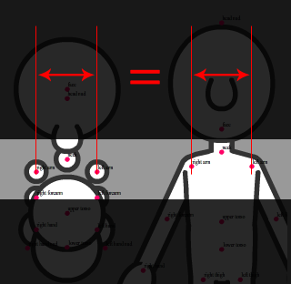

The widths of the two upper arm sprites (as well as the pivots) in the top
and bottom
views must be the same as the one in the front view (angle 0).
The joint widths (diameter) for each body part should also be the same for every angle.
