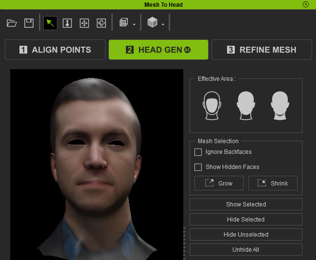

In the HEAD GEN section, you can select specific areas of the head to preserve while the software generates the remaining areas. This feature is beneficial for different types of models and guarantees optimal results. If there are any issues with the mesh, you can exclude problematic areas from the selection and allow Headshot 3 to correct them..png)
Note:
- The select tool lets you add or remove selected areas of your mesh.
For more information, see this page. - Before moving on to the next step, make sure to hide any unnecessary surfaces by using the Hide Unselected function. Failing to do so may negatively impact the REFINE MESH process.
Select an Effective Area that is most suitable for your model.

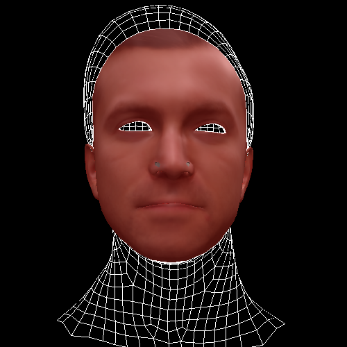

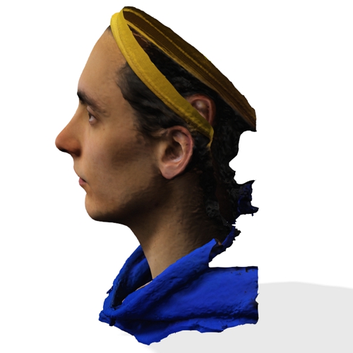

- Only Face
- Only Face will only preserve the face while the rest is generated by Headshot 3 Mesh Mode.
- Only Face option is suitable for models that only have the face portion visible or available.
Example 1
Example 2

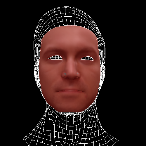

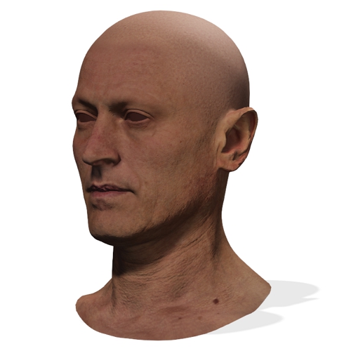

- Face and Ears
- Face with Ears will preserve the face and the ears while the rest is generated by Headshot 3 Mesh Mode.
- The Face with Ears option is suitable for models that only have the face and ears portion visible or available.
Example 1
Example 2

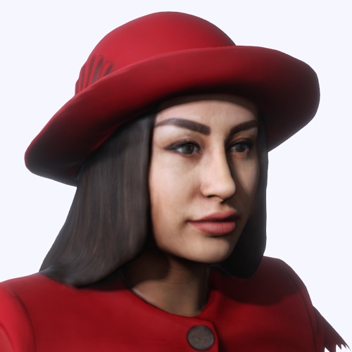

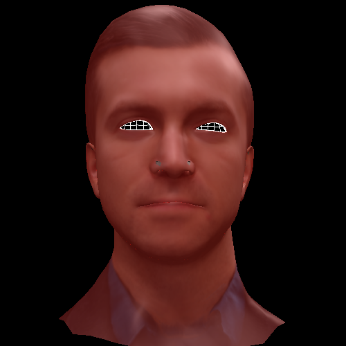

- Full Face
- Full Face will preserve the entire head.
- The Full Face option is suitable for models that have the entire head visible and available.
Example 1
Example 2
