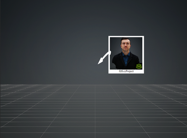

  1. Import your character model into CC5.
  2. If the model is off-center, select it and press F to recenter the mesh in the viewport.
  3. Pressing the F hotkey will center the model in your viewport, ensuring that it is facing forward.
    Before
    After

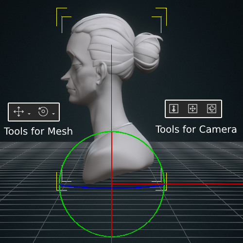

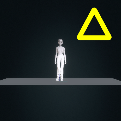

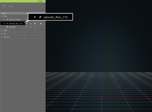

Resetting Source Mesh World Origin
After importing your model, make sure it is facing forward in the viewport and reset the model's base at world origin (0,0,0) by using World Move (W) and Local Rotate (E) to adjust its position and rotation. If needed, you can also modify the camera angle using Zoom (Z), Pan (X), and Orbit (C) for a proper view in the viewport.
Before
After

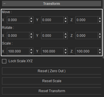

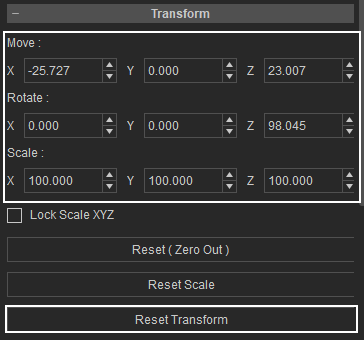

When you are satisfied with the angle of the model, perform Modify > Transform > Reset Transform to reset the origin value.
Before Reset
After Reset

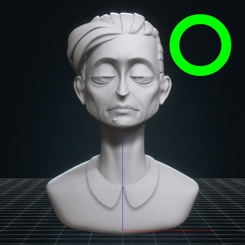

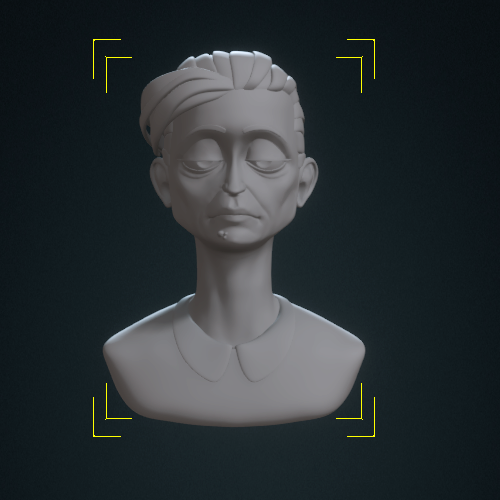

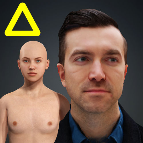

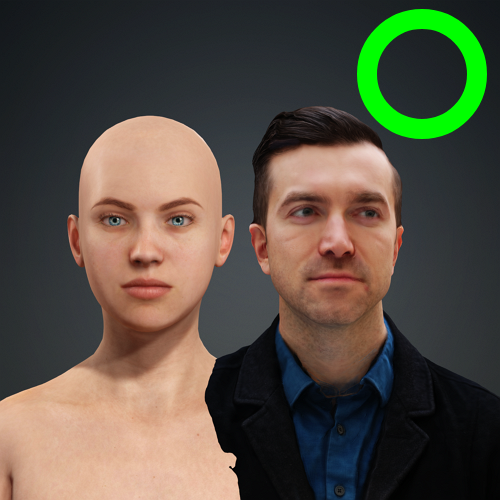

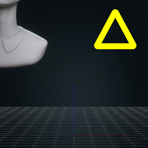

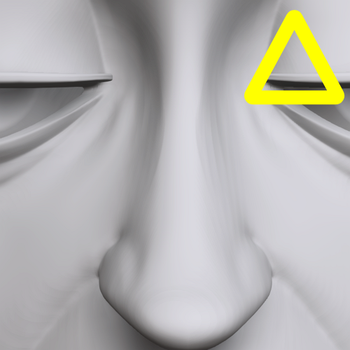

Head Model
In Headshot 3, the visibility of the model's face is of utmost importance as the focus is on capturing and generating facial features.

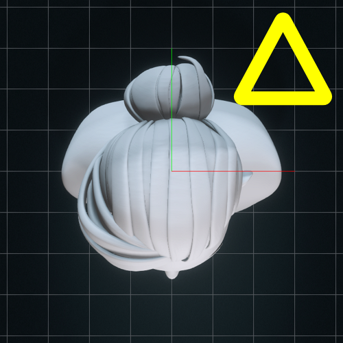

  • Mesh Angle
    Front view
    Side view
    Out of view
  • Camera Angle
    Front view
    Top view
    Out of view

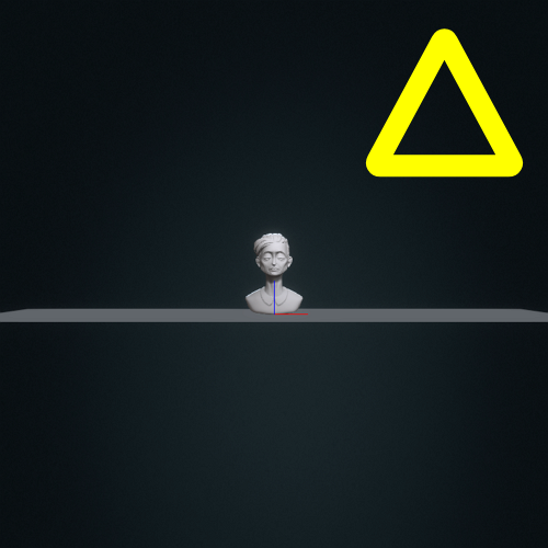

  • Model Distance
    Correct distance
    Too close
    Too far

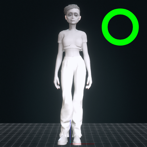

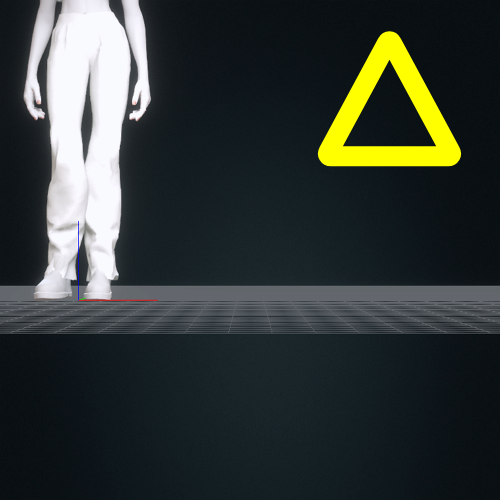

Full Body Model
When using a full-body model make sure the face is facing forward and the head is clearly visible in the viewport.
In Headshot 3, the visibility of the model's face is of utmost importance as the focus is on mapping and generating facial features.
  • Mesh Orientation
    Front View
    Side View
    Out of view

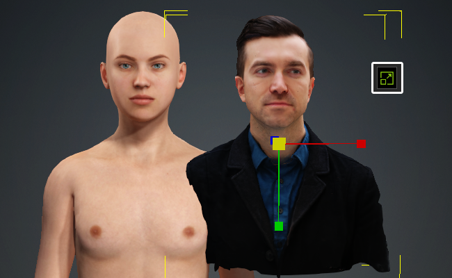

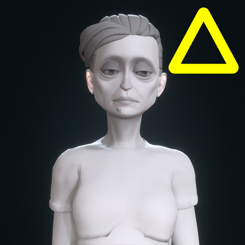

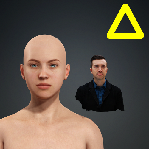

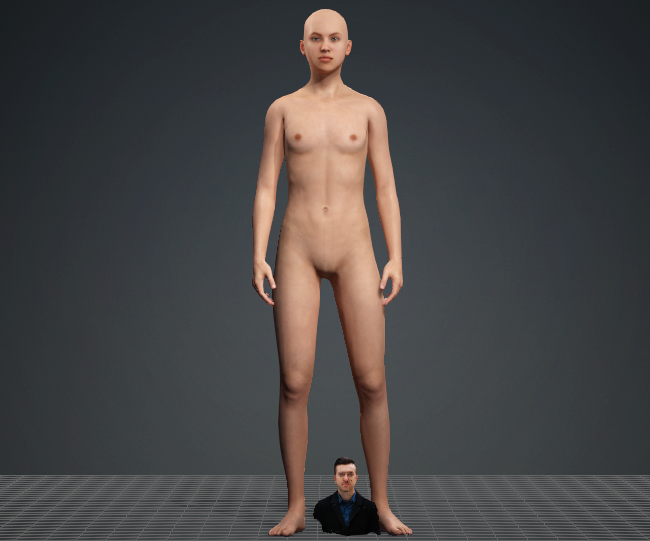

Mesh Model Size

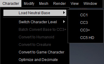

To check the size of your imported model in CC5, load a neutral character model as a reference, in this case a CC3+ Character. (Character > Load Neutral Base > CC3+).
  1. Import a model file into CC5.
  2. Perform Character > Load Neutral Base > CC3+.
  3. Use World Move (W) and Local Rotate (E) to adjust the position and rotation of the loaded character model.
  4. Select the mesh and use the Scale (R) tool to resize it according to your preference.
    Neutral Size
    Too Small
    Too Large

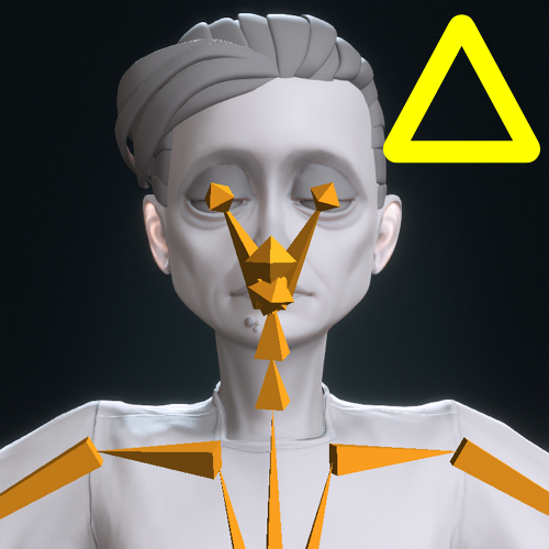

Removing Bones
To ensure consistency, remove the bones from your model prior to importing it into CC5. Otherwise, Headshot 3 will remove the bones during processing, which can lead to deviations in the model compared to the original.
Model without Bones
Model with Bones
