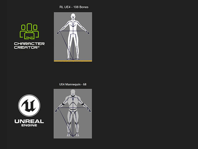

The CC3+ character rig consists of 108 bones, which is more than the 68 bones of the UE4 Mannequin character, allowing for full compatibility without animation errors because they share the same key bones.

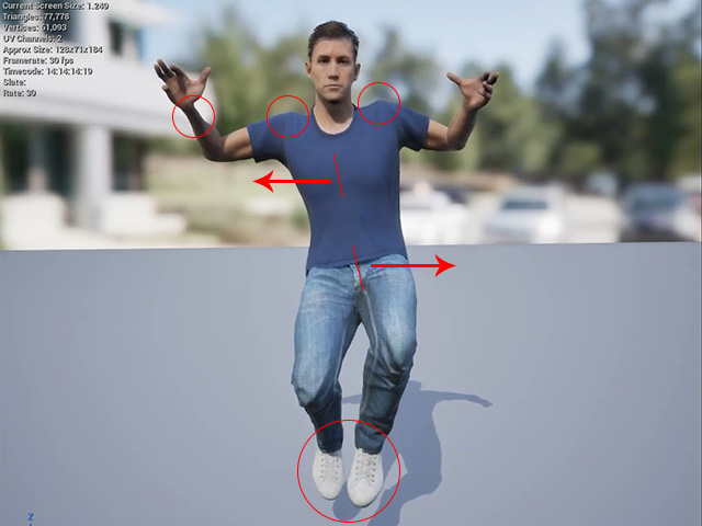

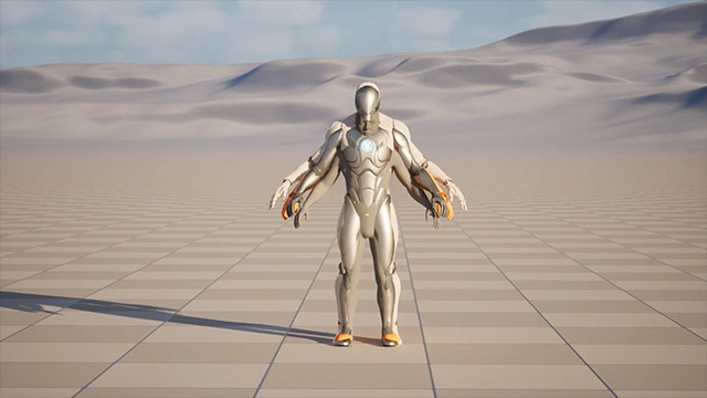

This change causes issues with CC3 Plus characters, resulting in incorrect retargeting of body and hand movements.
Character floating, spine misplacing, shoulders shrugging and wrong hand movements issue | Fingers twisting issues. |
