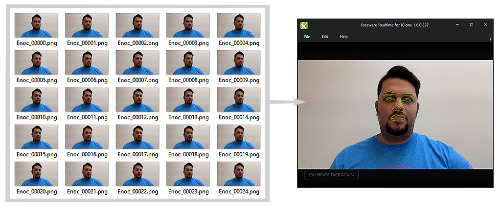

In addition to the camera, the
capture source for the Faceware Realtime for iClone can be Image Sequence as well.

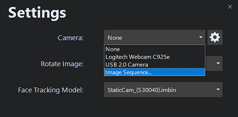

- Press the S key to open the Setting panel (Edit > Settings).
- Select Image Sequence... from the Camera drop-down list.

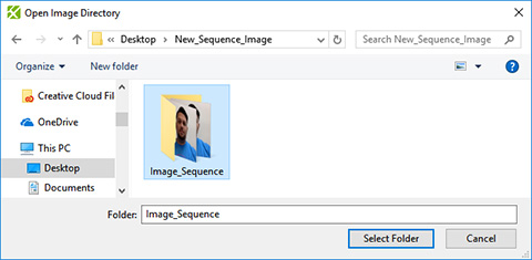

- Select a Folder in which the sequenced images are stored. Click the Select Folder button to load the images within the folder.

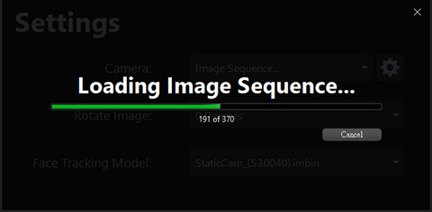

You will see the loading progress bar shown on the panel.
NoteMake sure to reserve several seconds with neutral facial expression for calibration at the beginning images because the server will auto loop the video and play back from the first image when it plays to the end of the image sequence.

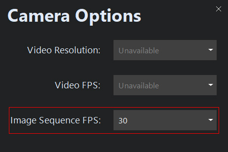

- Click on the Gear button next to the Camera drop-down list to show the Camera Options panel. Adjust the Image Sequence FPS to match the FPS when these images are created to
match the speed of the video.
NoteThe higher the value of the Image Sequence FPS, the faster the video will be played.
