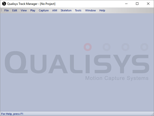

- After your actors has put on the sensors, launch Qualisys Tracking Manager.
- Create a new project.

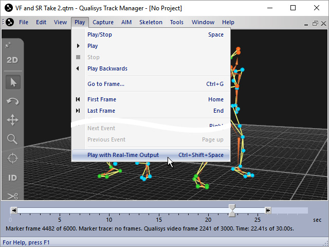

- Execute the Play menu >
Play with Real-Time Output command for broadcasting the data stream.

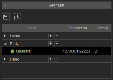

- To connect the Motion LIVE plug-in, add the gear to the Gear List (the IP: Port is fixed and can not be edit).

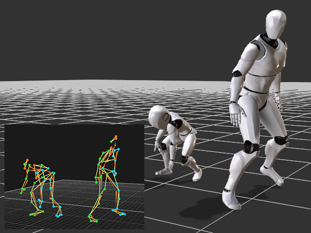

- Now the Qualisys streaming data can be transferred to iClone characters.
