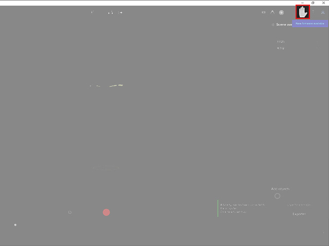

Hands Settings in Rokoko Studio V 1.19
- Click the Configure your SmartGlove button.

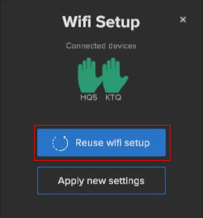

- Click the Reuse wifi setup button in the Wifi Setup panel.

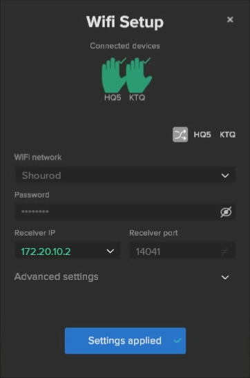

- Adjust the settings in the next page of the panel. Click the Settings Applied button and close the panel.
- WIFI network: Make sure you type in the correct domain name on which the Rokoko SmartSuit, Gloves, AP and computer that Motion Live plug-in are mounted or installed.
- Password: Type in the correct password for accessing the wifi domain.
- Receiver IP: The address of the Wifi Server device.
- Receiver Port: The port that for transferring captured motion data.

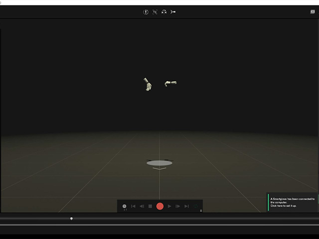

- As you can see the dummy hands in the 3D window appears incorrectly. It is because the Hands Calibration has not been performed.

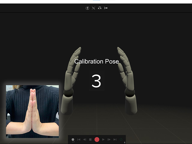

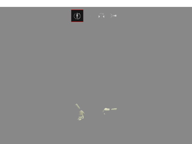

- Click the Perform Calibration pose on all live inputs button at the top of the application.
- The application starts to countdown, hold your hands in a prayer gesture, as shown in the illustration, until the calibration finishes.

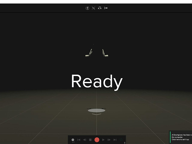

- When the screen shows Ready, then the calibration is finished and you can start to capture the performer's motions.
