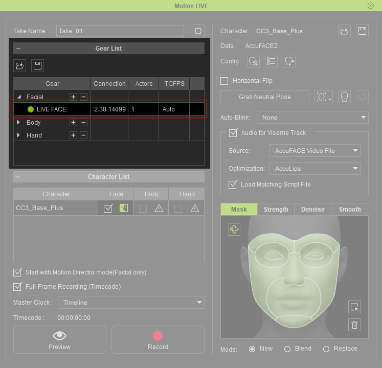

  2. Open Motion LIVE panel and make sure it is connected to the facial mo-cap device (LIVE FACE, for example).

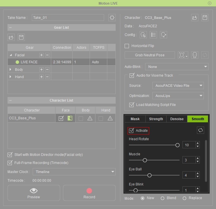

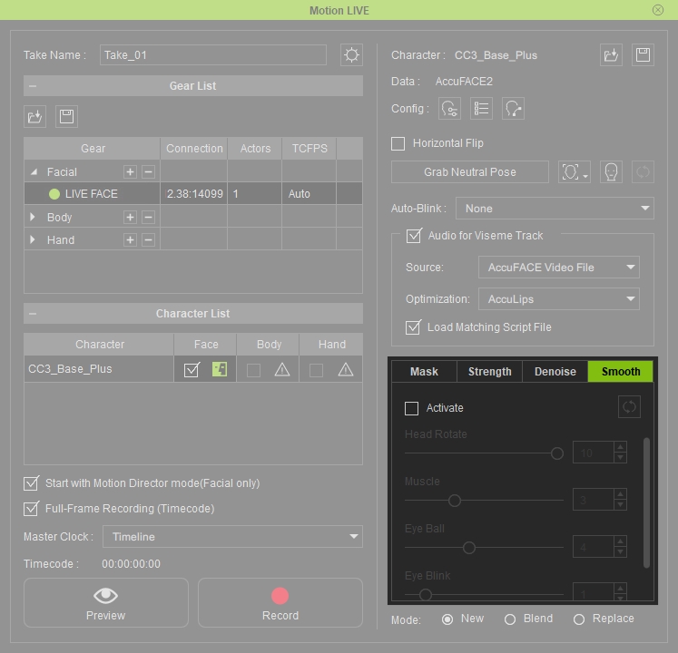

  4. Stop previewing, go to the Face setting page; switch to the Smooth tab.
  5. Check up the Activate check box.
  6. Drag the sliders in accordance with the parts that judder most.
