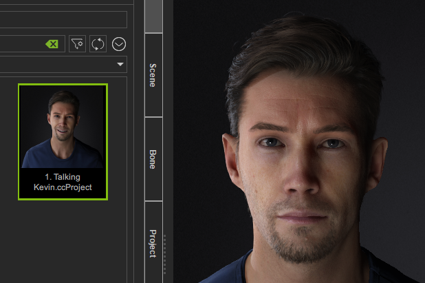

Prepare a character in iClone.

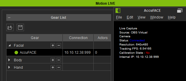

- Open the Motion LIVE panel and ensure the IP address is identical to the facial mo-cap device(using AccuFACE, for example).

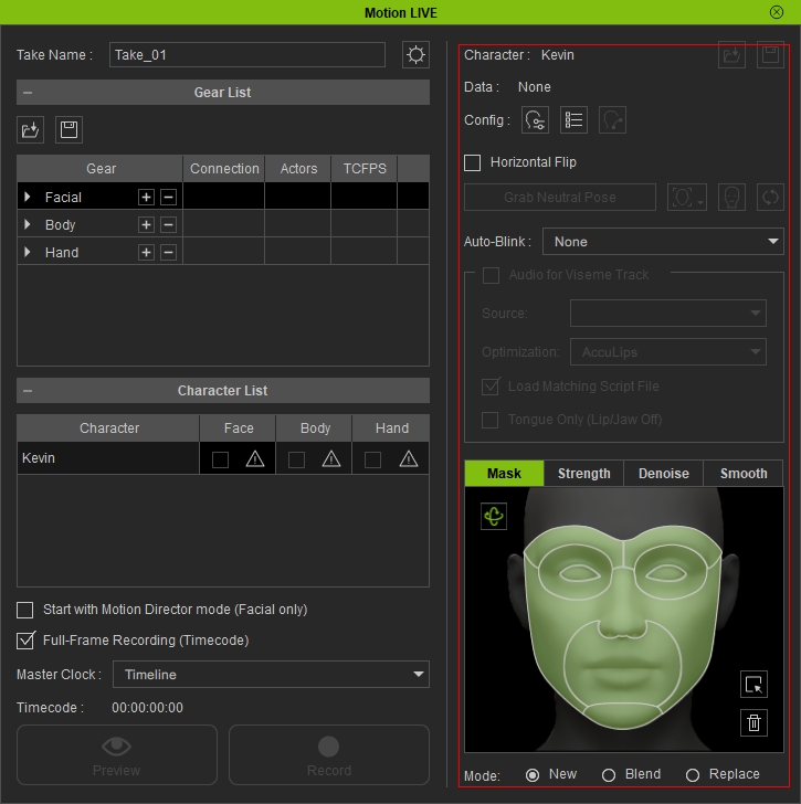

The Motion LIVE window will appear.
- Switch to the Denoise tab
- Turn on Activate.
- Use the sliders to reduce juddering on parts where it is most severe.
