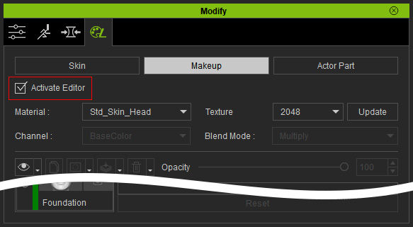

- Create a project and apply template from Skin or Makeup categories (in this case, Makeup).
- Check the Activate Editor checkbox in the Makeup page.

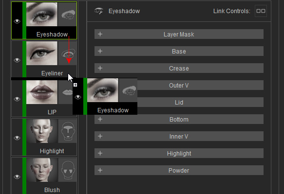

- Drag and drop the layer up or down to change the order.
- The effects from these two layers swapped.
