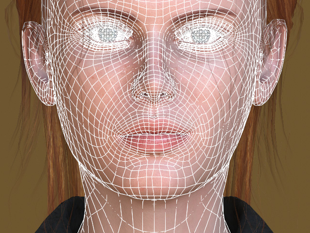

- Create a new project (in this case, the character is created by being imported into Character Creator with the Transform feature).

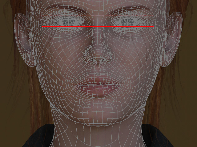

- Zoom in to the face and display the character in wireframe mode.

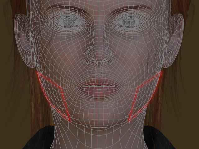

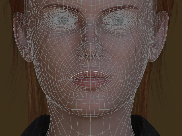

The issues are:- The mid-line is crooked.
The eyes don't line up vertically.

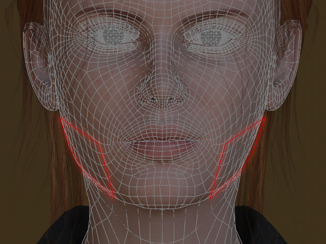

- The rightside mouth corner is higher.
- The right cheek dents
inward.

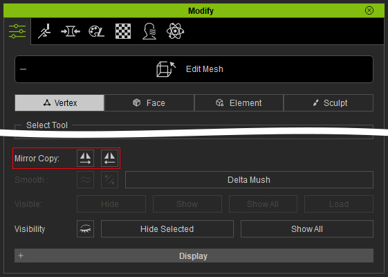

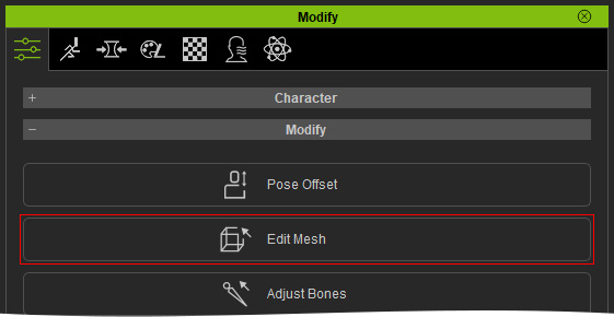

- Click the Edit Mesh button in the Modify section in the Modify panel.
- Switch to either Vertex, Face, or Element. Click the Right to Left or Left to Right button of the Mirror Copy (in this case, Left to Right).

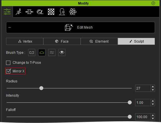

In Sculpt mode, activate Mirror X to sculpt the character's faces symmetrically.

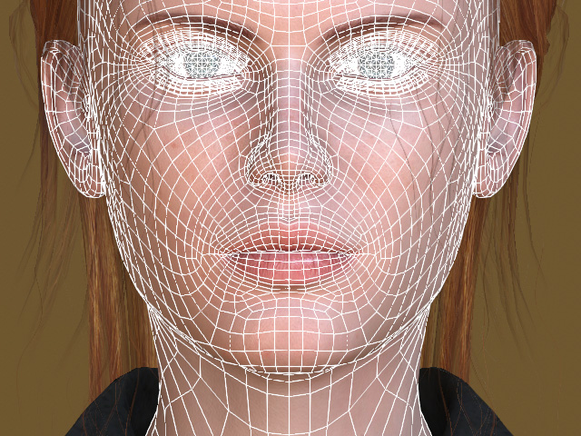

- Exit the Edit Mesh mode.
- The target vertices
will be re-positioned to their default locations.
- The mid-line is
now straight.
- The eyes are on the same horizontal
plane.
The mouth corners are aligned.
- The cheek
volumes are the same size.
- The mid-line is
now straight.
