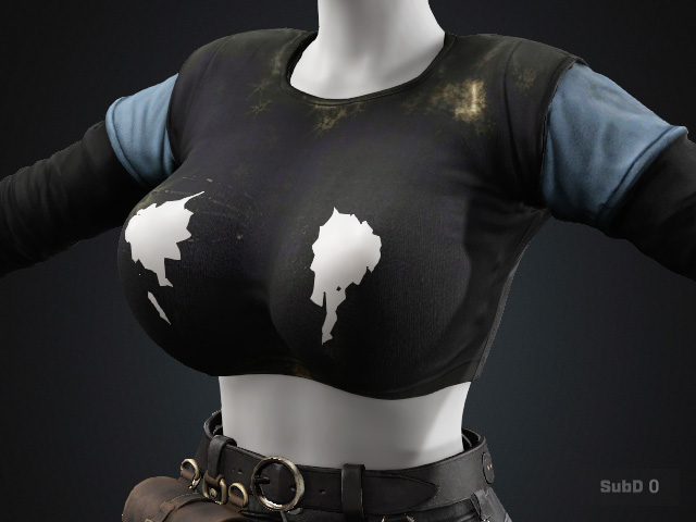

After you use the Conform Clothing feature, you may encounter mesh
penetration as shown
below:

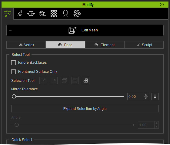

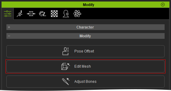

Select the mesh whose faces poke through the outer layer cloth, and enter the Edit Mesh Mode by clicking the Edit Mesh Mode button
in the Modify panel >> Edit tab >> Mesh Modifier section.
- Switch to the Face tab.

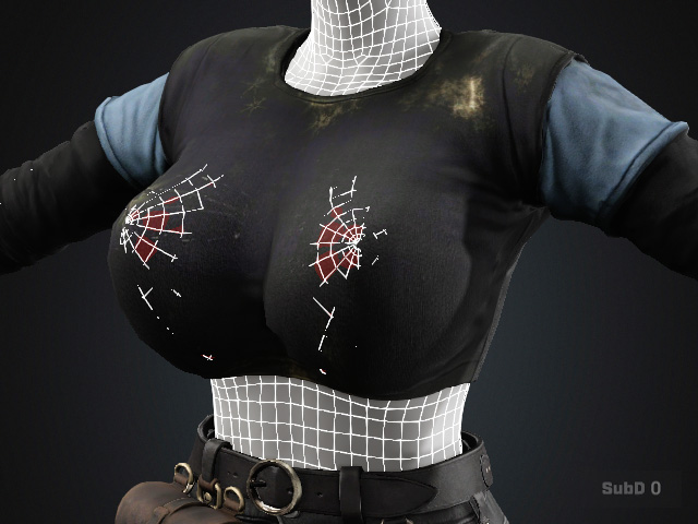

- Select the piercing faces.

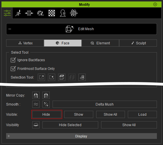

Click the Hide button to conceal these mesh faces.

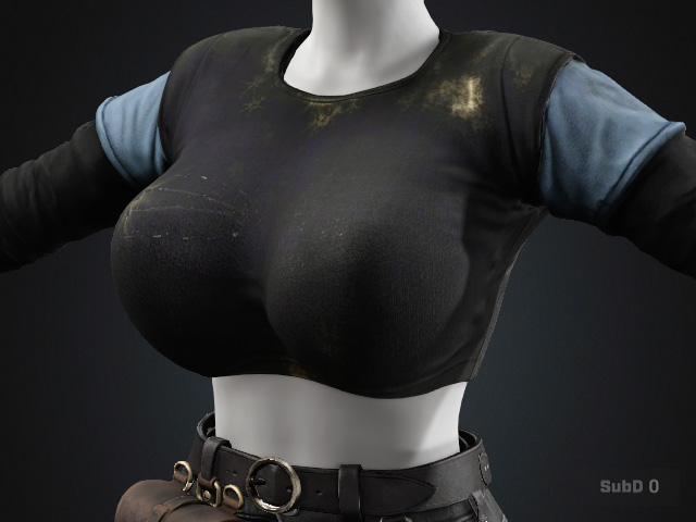

Click the Edit Mesh Mode button again to view the result.
Note:Click on the Show button in order to show the meshes that you do not want to hide.

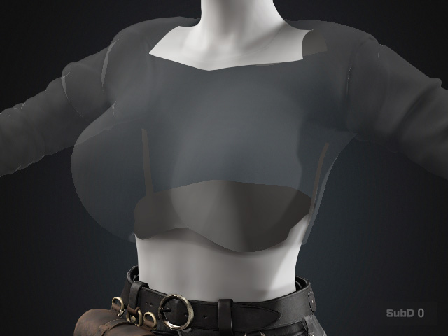

- The changes of the inner mesh faces in X-Ray mode are shown below
