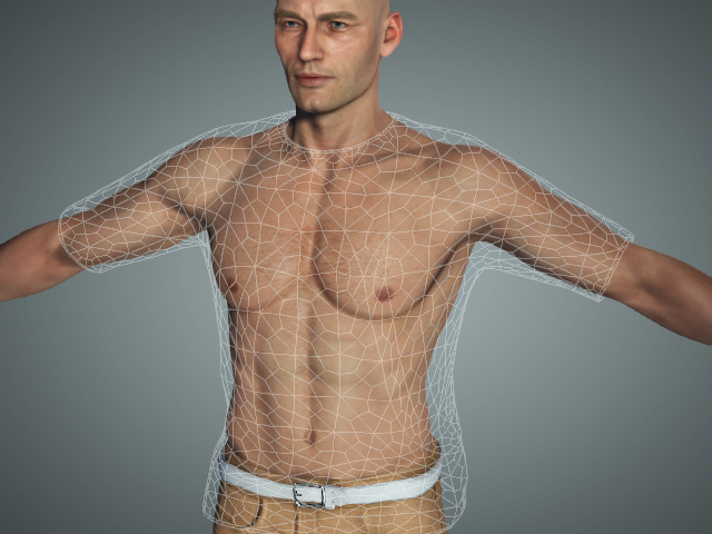

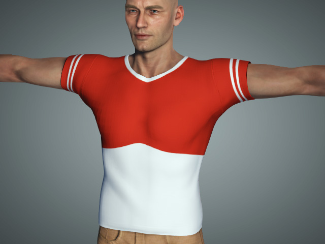

- Apply a cloth to the current character.
Set the cloth to wireframe mode to observe the auto-hidden status of the character.

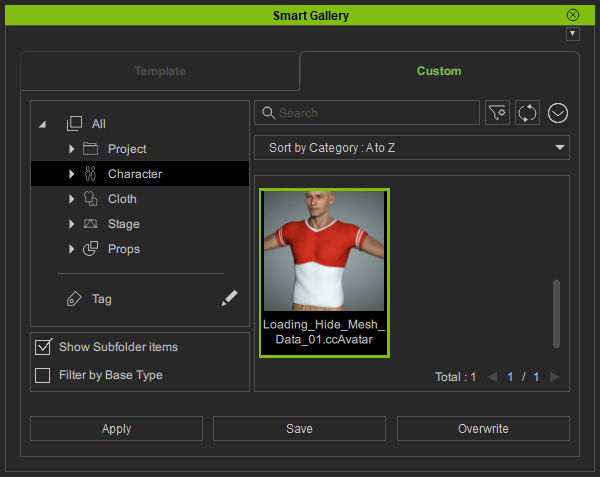

Save the character in *.ccAvatar format. The hidden mesh status will be saved to the character file.

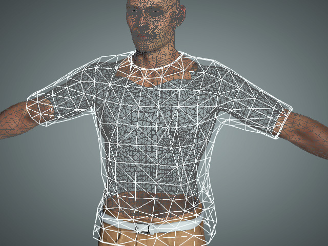

- Create a custom cloth to the character.
- This cloth is unable to auto-hide body meshes because it is a
custom cloth.

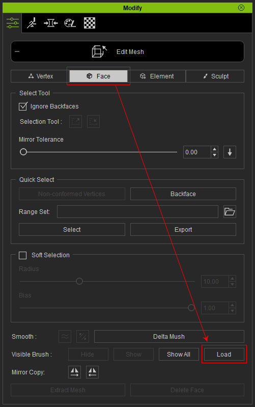

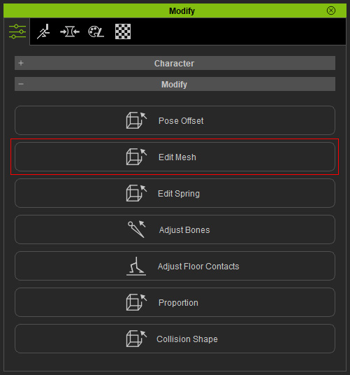

- Select the character and click the Edit Mesh button in the Modify panel.
- Switch to the Face mode, click the Load button in the Visible Brush group.

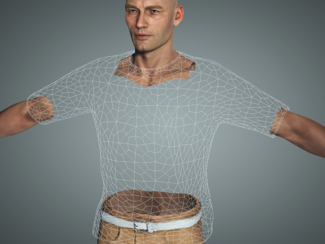

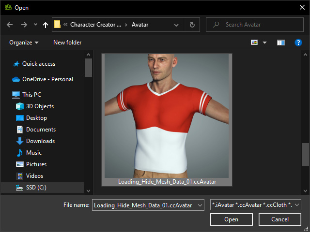

- Select the character saved in step 3 to make it a reference.
- The hidden status of the reference character will be extracted and applied to the character again.
You can optionally edit the hidden mesh faces after this step.

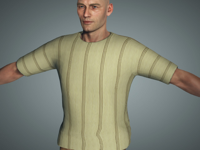

- Exit the Edit Mesh mode.
