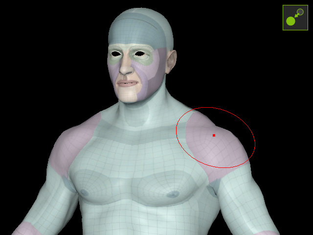

The Refine Mesh step provides five surface brushes—Move, Smooth, Clone, Project, and Erase—for refining the shape of the CC5 HD character to match the imported character model.

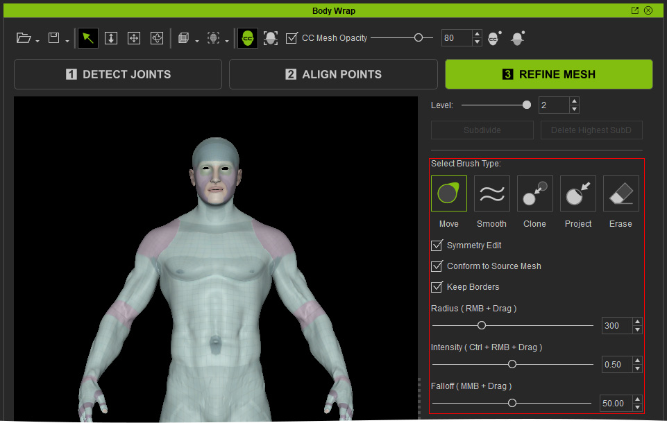

Brush Settings
Setting
Description
Symmetry Edit
Enables symmetrical editing on both sides of the character.
Conform to Source Mesh
Keeps the CC5 HD surface conformed to the imported character model while using the Move or Smooth brush. This allows surface adjustments to follow the shape of the source mesh during editing.
Keep Borders
Preserves the borders (eye sockets and mouth) of the edited area when using the Move or Smooth brush, helping prevent the surrounding mesh from being unintentionally affected.
Radius
Sets the size of the brush area. A larger radius affects a wider surface area, while a smaller radius allows more precise editing.
Intensity
Sets the strength of the brush effect. Higher values produce stronger deformation, while lower values produce more subtle changes.
Fall Off
Sets how gradually the brush effect fades toward the edge of the brush area. Lower values produce a sharper edge, while higher values create a softer, feathered edge.
Falloff = 100
Falloff = 0
Move and Project

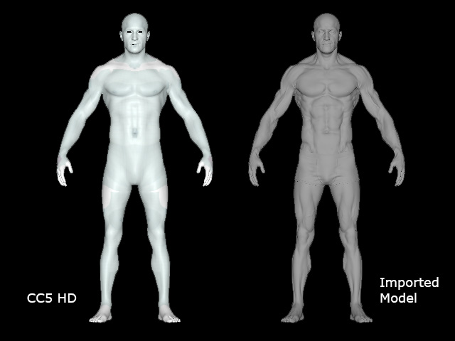

The Move and Project brushes can be used together to precisely conform areas of the CC5 HD character that are not fully aligned with the imported character model. After Auto Projection, some areas of the CC5 HD character may remain slightly inside the surface of the imported model.
  1. Imported model mesh
  2. CC5 HD character mesh
In such cases, using Project brush alone may not fully conform the surface.

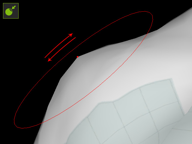

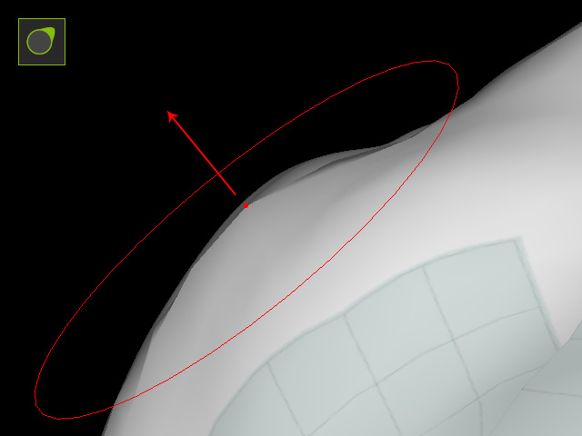

  1. Select the Move brush and push the recessed area outward until the CC5 HD surface extends slightly beyond the corresponding surface of the imported model.
    Use Move tool to move the surface outward

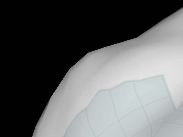

    Result

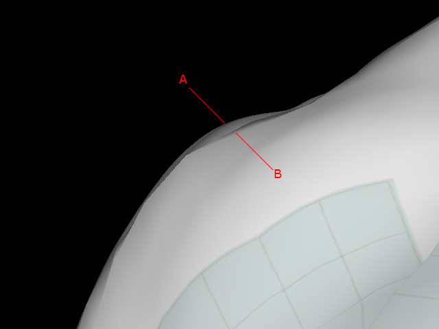

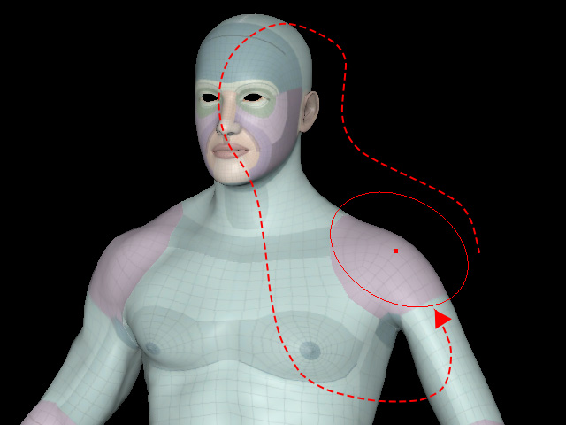

  2. Switch to the Project brush and brush over the adjusted area to project the imported model's surface onto the CC5 HD character.
    Brush over the extended area
    Result

  3. Continue applying Project brush as needed until the CC5 HD surface closely matches the imported model without being recessed or protruding beyond it.

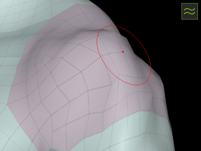

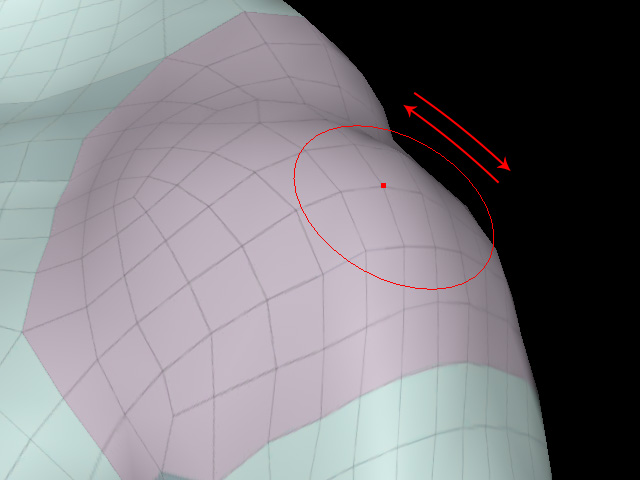

Smooth
The Smooth brush averages the wireframe distribution within the brush area to smooth the CC5 HD character's surface. Use Smooth to soften uneven or irregular areas created during surface editing.
Before
After
For information about using Smooth with Conform to Source Mesh, see Using Move and Smooth Brushes with Conform to Source Mesh.
Smooth Brush (with Conform to Source Mesh)
