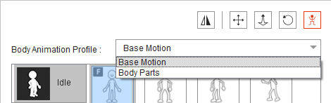

Select Base Motion from the Body Animation
Profile drop-down list.

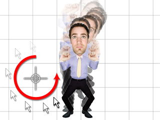

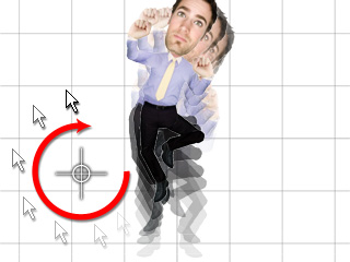

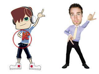

- The character will then perform the built-in motion of the template when you move your mouse in a circle.
A clockwise circle motion will cause the character to move forwards.
A counterclockwise circle motion will cause the character to move backwards.
- The faster the mouse moves, the faster the character moves.

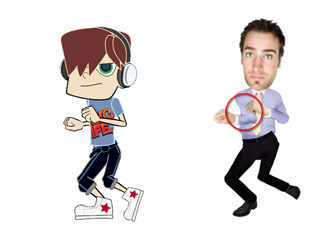

Record button and press the Space bar to start recording the motion during puppeteering. The motion can be triggered with the same mouse manners as you did in the preview mode.
- Press the Space bar or ESC key to stop recording.
Once the recording stops, a clip containing all the recorded motions will be stored as a single clip in the Motion Track of the character.
Click the Play button on the play bar to view the recorded puppeteering results.

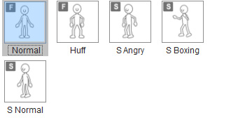

- Use the front preset for front characters, and the side preset for side characters. Mix and matching presets may sometimes cause unexpected layer issues.
The Front preset: Represented with an "F" on the top-left of the icon.
The Side preset: Represented with an "S" on the top-left of the icon.
