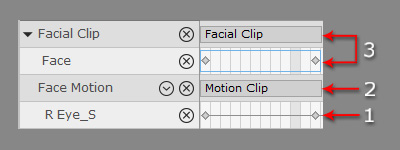

- General Facial Features:
Switches in the S track >
Clips in the Face Motion track >
Clips in the Facial Clip track and its keys in the Face sub-track.

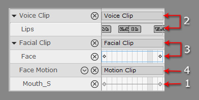

- Mouth:
Clips in the Voice Clip track and its keys in the Lips sub-track >
Clips in the Facial Clip track and its keys in the Face track >
Clips in the Face Motion track.
