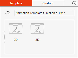

3D Motions (.ct3DMotion) in Cartoon Animator
The motions of this type are, by default, in the path below:
- Windows - C:\Users\Public\Documents\Reallusion\Template\Cartoon Animator 4 Template\Motion\G2\Editable 3D\
- Mac - \Users\Shared\Reallusion\Template\Cartoon Animator 4 Template\Motion\G2\Editable 3D\

2D Motions (.ctMotion) in CrazyTalk Animator 2
- Windows - C:\Users\Public\Documents\Reallusion\Template\Cartoon Animator 4 Template\Motion\G2\Flatten 2D\
- Mac - \Users\Shared\Reallusion\Template\Cartoon Animator 4 Template\Motion\G2\Flatten 2D\
