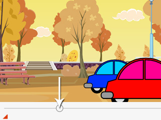

Open the project with animations of different objects. Start from the

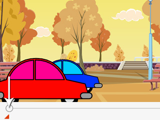

first frame (two cars moving for example).
Animations start from the first frame.

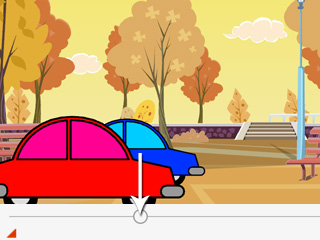

Animations stop at one middle frame.

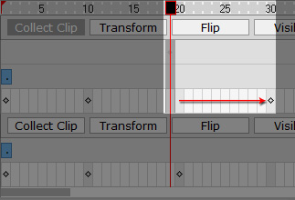

- Press down the Project button. Click the first frame on the track.
Click the
Insert Frames button on the tool bar. Enter a frame number
before the start frame.
- Click the OK button and the specified number of frames will be added before the start frame. The animations will be postponed (The cars start to move later) and the total length of the project will be increased.

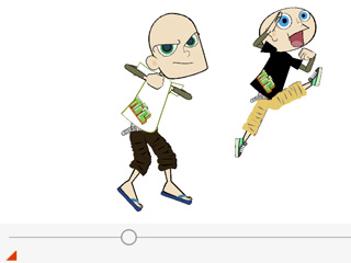

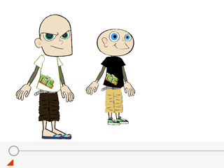

Given a project with two characters performing the same motion by body
motion keys.
Same start poses
Motions end at the same time frame

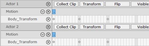

Open the Timeline (F3). Show the Body_Transform tracks of the two characters.
Since their motions are identical, the keys positions will be at the same time frame.

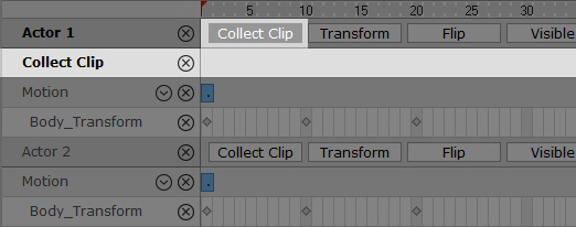

Click the Collect Clip button of one character to show the
corresponding track.

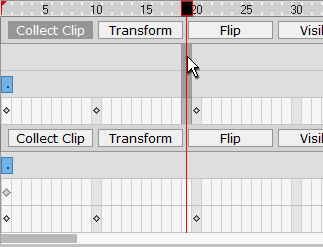

Click on the cell where you need to insert frames.
Click the
Insert Frames button on the tool bar. Enter a frame number.
Click the OK button and the desired number of empty frames will be added.

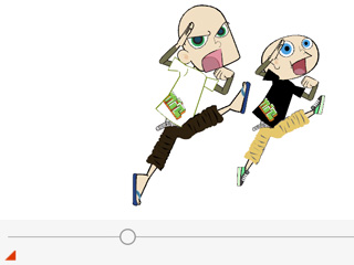

The time of the two keys will be extended, as well as the transition motion
in-between.
Same Start Pose
The transition duration extends
