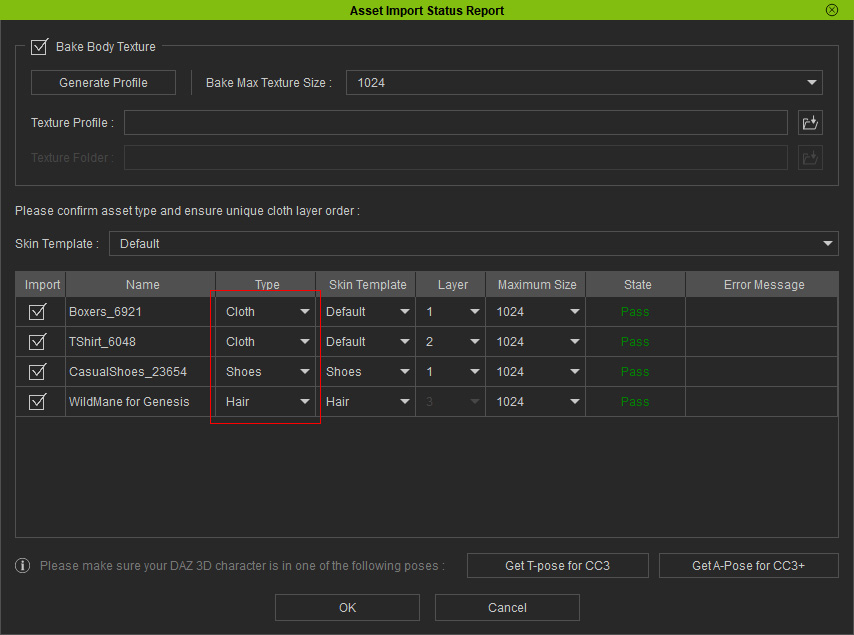

- When you encounter the dialog box, click on the ADVANCED button for auto-detecting and loading all textures the character ever be applied with in DAZ.
- In the Asset Import Status Report panel, activate the Bake Body Texture to adopt the DAZ textures for the converted character's Body skin, Eyes, Eyelashes, Teeth and Nails materials.
You can also set the textures' sizes after baking by choosing from the Bake Max Texture Size drop-down list. - Identify the content types for the character in the Asset Import Status Report panel.
Note:- Usually, the Hair type needs to be manually selected.
- If you skip the step 2 previously for applying A-Pose to the character, then you can click the Get A-Pose for CC3+ button at this step to put on the A-pose to the character in DAZ 3D.
- Click OK to import the character and its assets. The DAZ 3D character
is thus converted successfully in Character Creator.

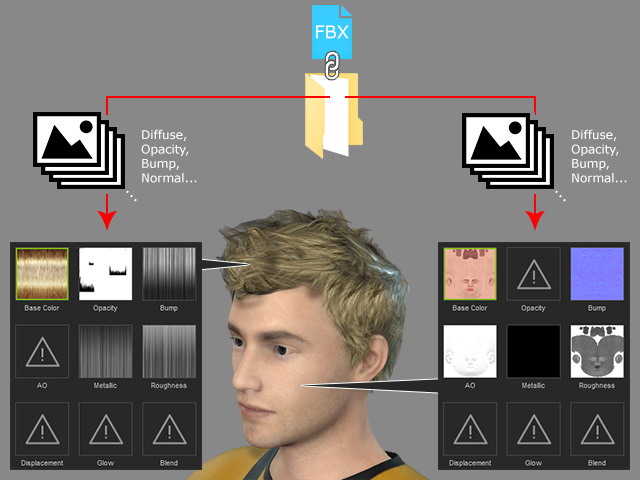

- All the textures ever applied to the character in DAZ will be auto-loaded. You can check out the channels in the Texture Settings section. The folder is by default in the path: C:\Users\Public\Documents\My Daz 3D Library\Runtime\Textures\...
