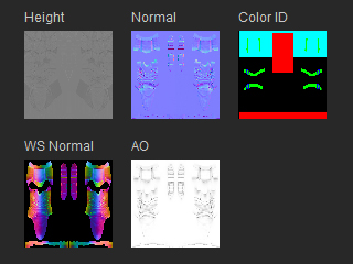

Given an object with complete maps in the Mesh Data section.
Maps of the object in Mesh Data

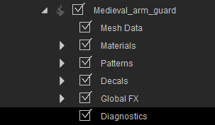

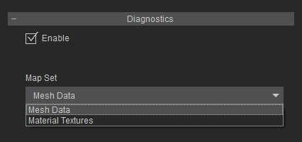

Select the Diagnostics node in the tree view.
In the Diagnostics section, activate the Enable checkbox

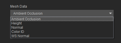

and choose Mesh Data for the Map Set.
Choose the items from the Mesh Data drop-down list to view the wrapping results of different maps on the object
in the view port.

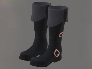

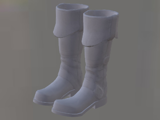

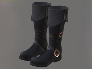

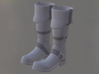

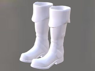

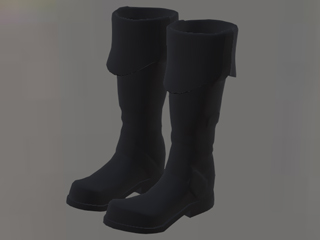

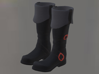

Original Look

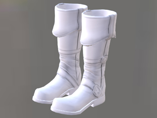

Ambient Occlusion
Height

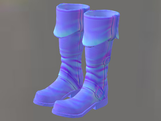

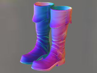

Normal

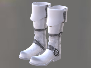

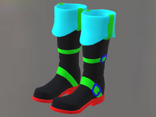

Color ID
WS Normal

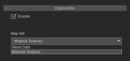

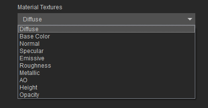

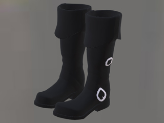

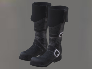

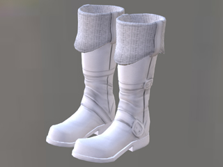

In the Diagnostics section, activate the Enable box and choose the Map Set to Material Textures.
Choose the items from the Material Textures drop-down list to view the wrapping results of different maps on the object
in the view port.

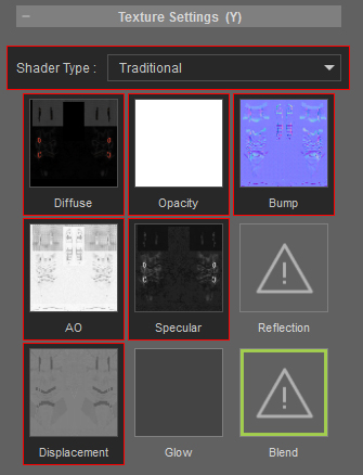

For Traditional Shader Type:
Diffuse
Opacity
Bump (and Normal)
AO
Specular
Height (for Displacement)

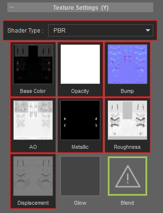

You can check out the channels by switching to the Traditional Shader Type in the Material tab of the Modify panel.

You can check out the channels by switching to the PBR Shader Type in the Material tab of the Modify panel.
