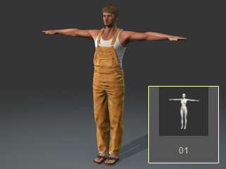

Prepare a character.

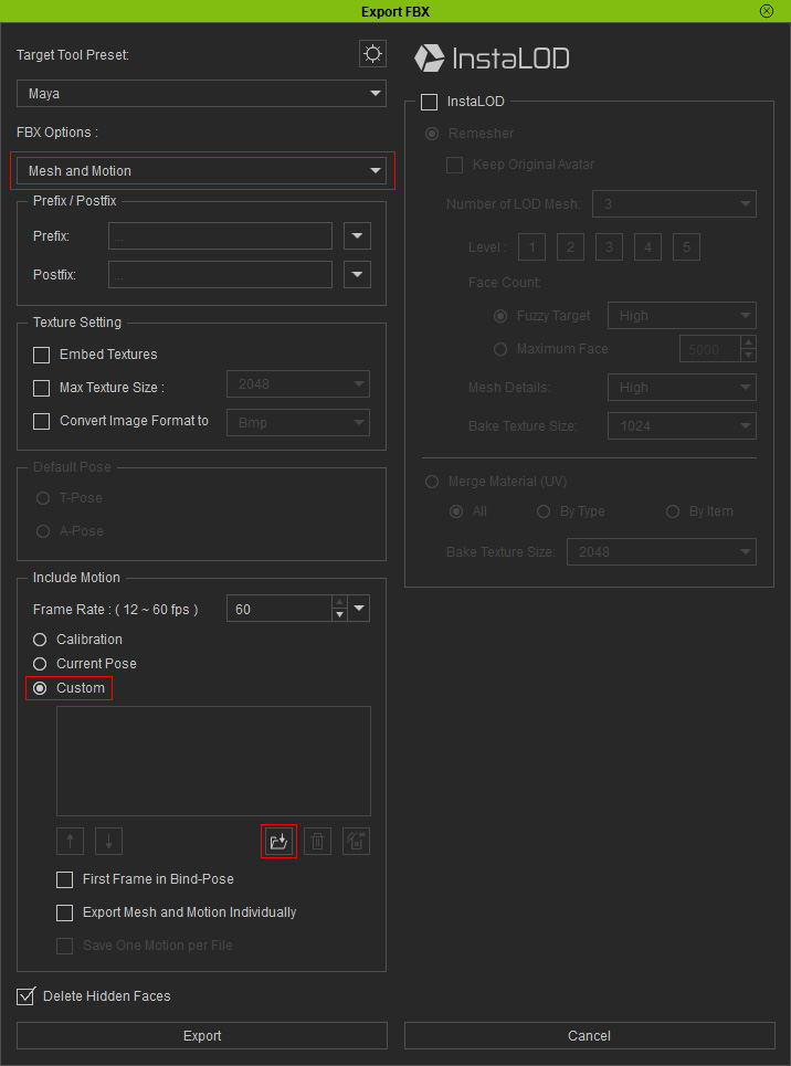

Execute File >> Export to Fbx >> Clothed Character command.
In the following panel, set the export type to Mesh and Motion and choose
the Custom option, click the Open File button.

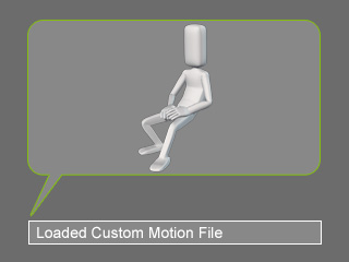

- The Custom option lets you include an .iMotion or .iMotionPlus animation track along with the FBX file.
An iMotion is a motion file with body motion only while an iMotionPlus includes body motion and facial expressions.

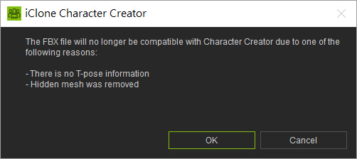

- When you export the character with the settings above, a warning message should appear. Skip over this pop-up by pressing the OK button.

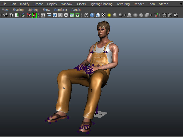

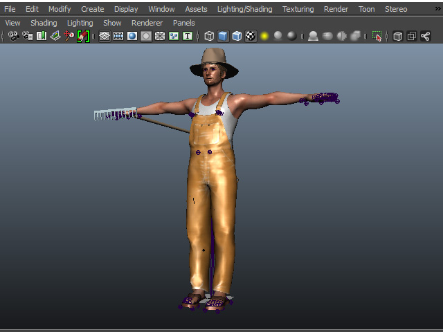

Edit the motion in another 3D software.
Before editing in (Maya)

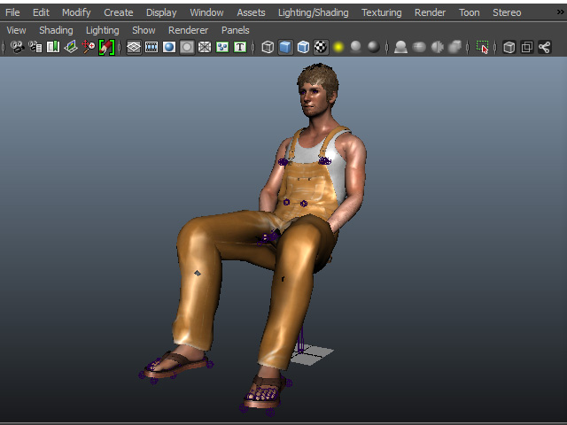

After editing

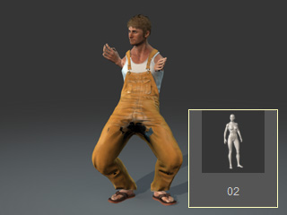

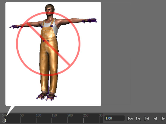

Loading the character back into Character Creator without the inclusion of the T-pose can lead to body deformations and other oddities.
Incorrect T pose
Other poses applied can have strange effects.

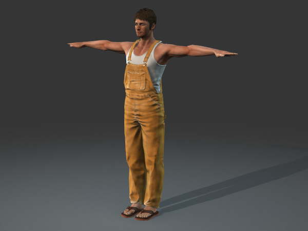

Universal T-pose Editing

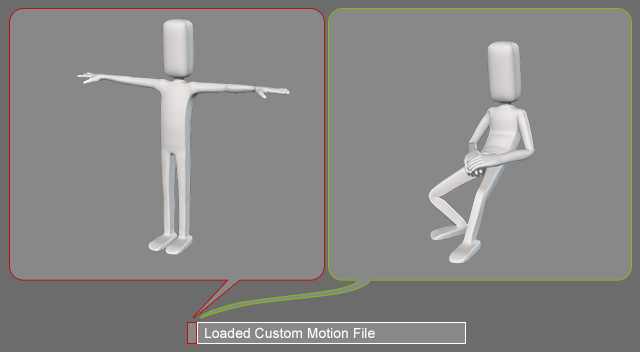

If Universal T-pose Editing is activated, then you are free to create Character Creator compatible assets in 3rd party 3D applications.

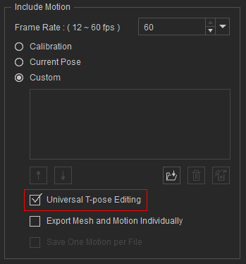

Activate Universal T-pose Editing.
A T-pose will be inserted one frame ahead of the time-line motion. -
Create custom asset(s) at the T-pose frame of the
character with an external 3D application.
- You are free to edit the motion with the exception of the first T-pose frame.

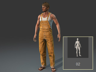

If you want to edit the body shape or the outfit of the character
in Character Creator, then
Do notedit the first frame T-pose, however, adjustments in the following frames are permitted.

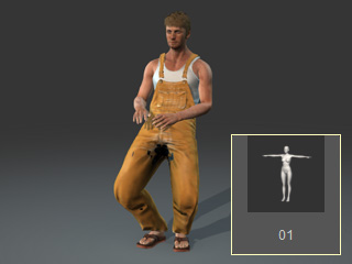

- The adjusted animation can be brought back into Character Creator using the FBX format for further editing without any issues due to the inclusion of a pristine T-pose frame.
The T-pose is retained.
Other poses can be applied without a problem.
