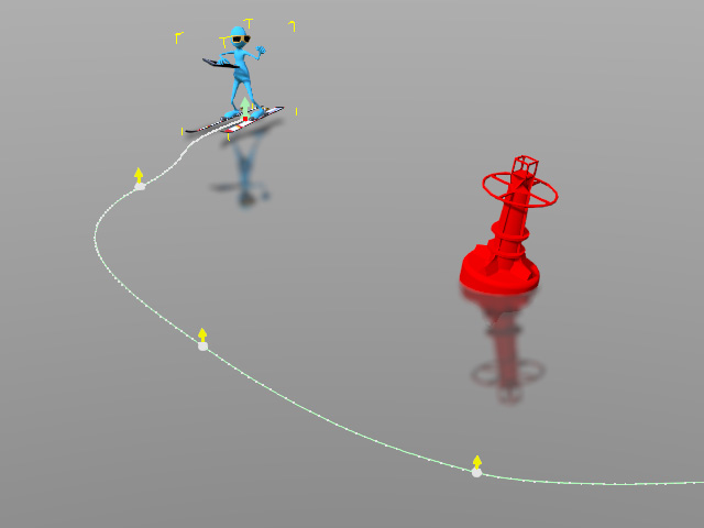

Apply a character and animate it with every tool in the box: link, reach, look at, path, apply motion clip,
etc.
- Select the character.

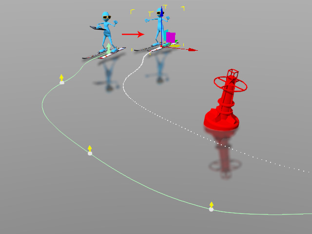

Hold the Ctrl key and drag to move the character. As you can see, a
copy of the character is generated.

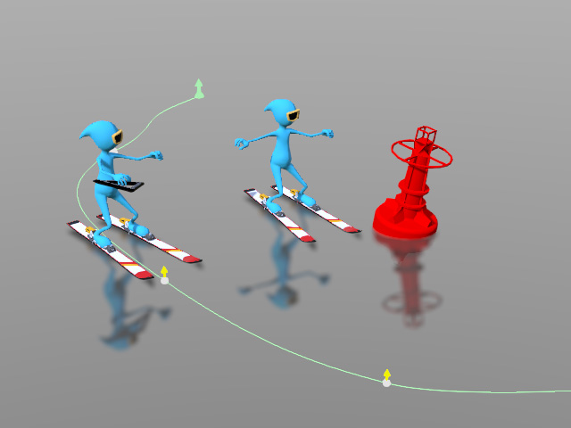

Play back and you will see the copied character performing the same motion as the original one.
Both characters will end up looking at the same target (the buoy in this example) and reach out to the same object (the triangle handle ).
