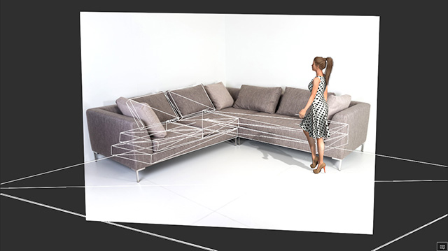

- Make sure the camera angle matches those of the background image or video.
- Select or create a floor plane that will be used to receive cast shadows.

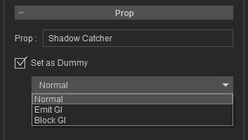

- Under Modify > Prop > Set as Dummy, select Normal from the drop-down list.

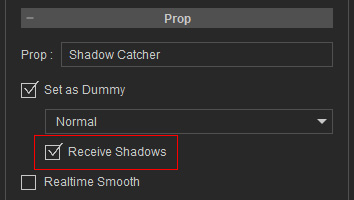

- Activate the Matte Shadow check box, the plane will turn hidden from view but still receive cast shadows.
