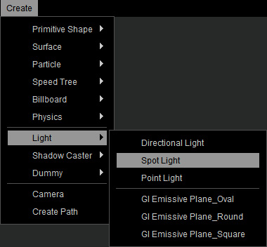

  2. Execute the Create > Light > Spotlight command to create a spotlight.

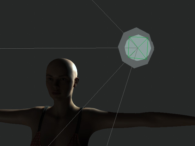

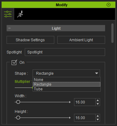

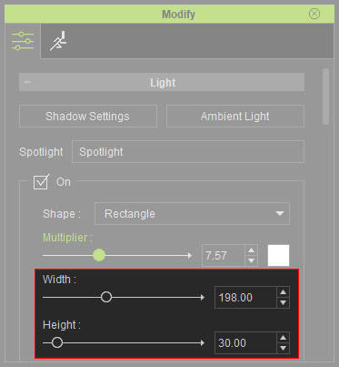

  4. Make sure the spotlight is selected and go to the Light section in the Modify panel. Change the Shape drop-down list to Rectangle.
    You will see a shape shown at the same position of the light.
  5. Drag the Width and Height sliders to determine the desired shape of the light.
    The shape will then be resized.
