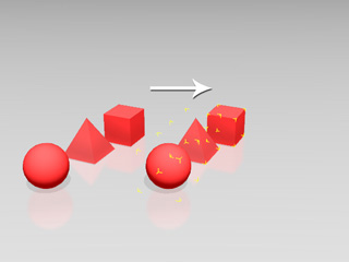

Duplicating Props with Ctrl Key
Select one or more props you want to duplicate.
Switch to the object transform tools such as Move (
or
Rotate (
or
or Scale
tool.
Hold the Ctrl key and then move, rotate or scale the select props. The same props will be duplicated.
Repeat several times to duplicate more of the same props.

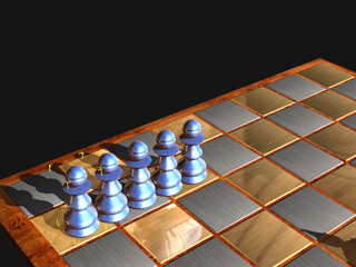

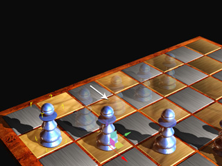

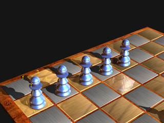

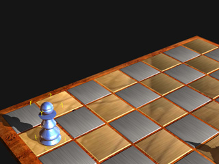

Collaborating with Object-Moving
Select the pawn.
Click the Edit >> Multi-Duplicate command on the main menu bar
to show the panel.
In the Duplicate numeric field, set the number for duplicating. The minimum number is 2.
Enter the number to the Move X, Y or Z to duplicate at a certain
offset distance.
Move X is increased.
Alternatively, toggle the gizmo mode
so that you may drag to decide the moving offset.
Each pawn offsets the same distance from the previous one.
- Click the OK button when you are done.

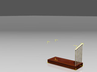

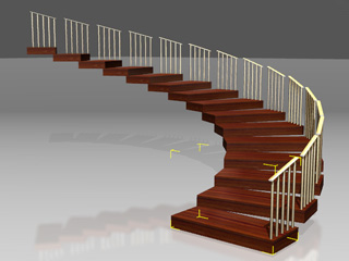

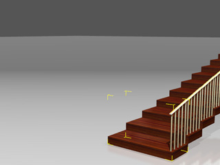

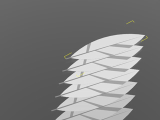

Collaborating with Object-Rotating
Select the step.
to show the panel.
- In the Duplicate numeric field, set the number for duplicates. The minimum number is 2.
Move the duplicated steps so that they align to the appropriate
position.
Rotate the duplicated steps to create a spiral staircase.
Each step rotates the same angle from the previous one.

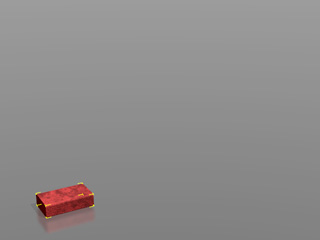

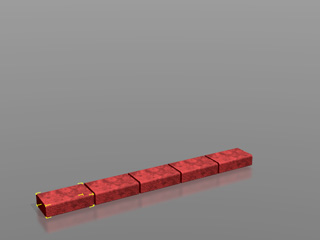

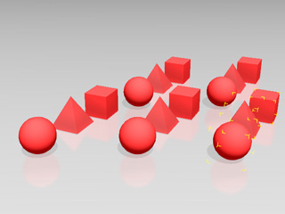

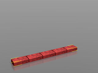

Producing a Prop Array by Multi-Duplicate
In the previous section you learned that the Multi-Duplicate feature supports only a single prop; however, when you want to create a prop array, such as a brick wall, then you may still use the Multi-Duplicate feature with the attaching method.
Select a brick.
Duplicate the brick by the Multi-Duplicate panel.

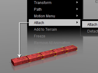

Select the duplicated bricks and right-click on the 3D preview window. Attach all of them to the first brick to create a group.

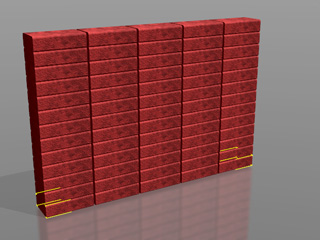

Select the group.
Perform duplication again. You may need some adjustments to the duplicated group in order to align them to the appropriate positions.
- Optionally detach the sub-nodes of each group if necessary.

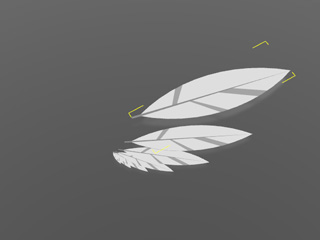

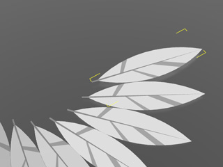

Using Spatial Offset
Basically, the duplicate distance, angle or size (also called Spatial Offset) between two adjacent duplicated props is a constant number specified by you. However, the space offset can be progressively increased or decreased. This can duplicate your prop with more geometrical graphics.

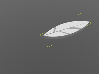

Apply a prop and select it.
- Open the Multi-Duplicate panel.
Set the Move to line up the duplicate props.

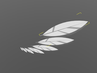

Change the Rotate.
Adjust the Scale values.
The duplicated props are scaled down.
Drag the Spatial Offset slider to increase or decrease the offset quantity.
Spatial Offset is decreased.
