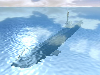

Refraction above the Water Surface
This parameter specifies how intense the refraction effect will be rendered when the camera is above water.
  1. Go to the Modify panel and the Advanced Water Parameters section.
  2. Scroll up to the Refraction parameters.
  3. If you intend to modify the refraction strength above the water surface, drag the Above Surface Strength slider.
    The higher the value is, the stronger the refraction shows when the camera is above the water.
  4. Increase the Blur value so the refraction turns to be vaguer.

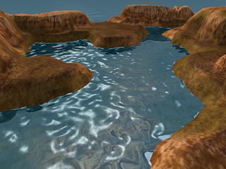

Refraction under the Water Surface
You may follow the same steps as above to adjust the refraction under the water surface. This time use the Under Water Strength slider.
