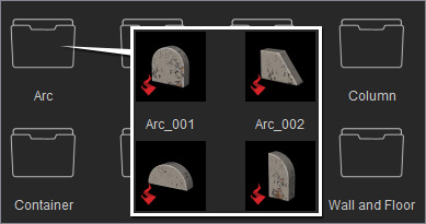

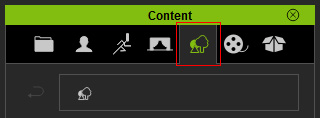

To find the props applied with substance material, you may follow the steps below:
Switch to the Set tab in the Content Manager.
Open the Set Template >> Props >> 3D Blocks (Substance)
folder.
You may find the embedded props of this kind in different sub folders.

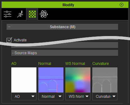

If you want the custom model to have correct mapping result, four unique maps
(UV dependent) are required to make it fully compatible. They are:
Normal, Curvature Map, WS Normal, and AO. These
four maps must be load to the four channels under
Substance >> Source Maps
You are able to bake those maps by using Substance Designer.

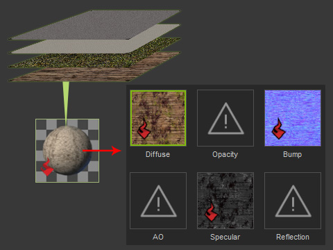

iClone Substance Materials on 3D Blocks

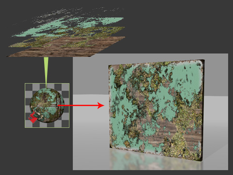

An iClone substance material on any substance 3D block is composed of multiple layers; the basic adjustments for each layer can be individually done. Besides, each layer can be designated with different Diffuse, Normal and Specular channels in iClone.
The layers form the substance material; and the substance material result is passed to the eight channels. |
Benefits of Using Substance 3D Blocks
By adjusting the parameters of the layers, including the density and masking method, the looks of the layers
are altered and passed to the texture channels of an object, which create a
realistic texture for the 3D object.

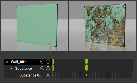

The parameters for the layers can all be keyed, which means you are able to generate dynamic weathering, erosion, scratching,
or mossing animation for the object.
