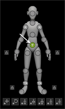

Select any one of the effector points from the dummy pane.

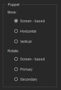

At the right side of the panel, choose one of the radio buttons in the Puppet section.
The buttons in the Move group are for moving the selected
effector points; the ones in the Rotate group are for
rotating the selected effector points.

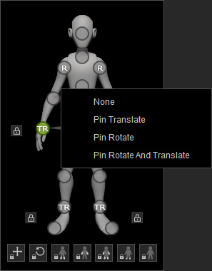

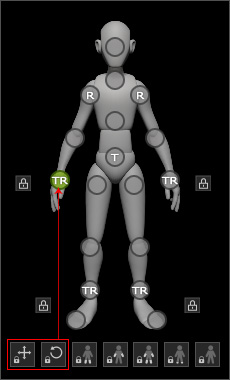

- If some other effector points are triggered to move during preview, which is not what you want, then select the effector points and activate the Lock Move or Lock Rotate buttons located under the puppet; the effector points will be locked from being moved or rotated when both pins are applied.
Alternatively, right-click on an effector point to manage its lock settings.
Repeat Step 1 to 4. The locked body part will not be triggered to move.
