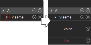

- Click the down arrow button of the actor track and show the Viseme track.
Press down on the triangle next to the Viseme track. You will then see the Voice and Lips sub tracks.

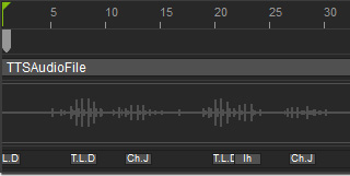

The wave line may be used as a reference for adding lip-synching keys. -
In the Lips Track, you may see the auto-generated keys.

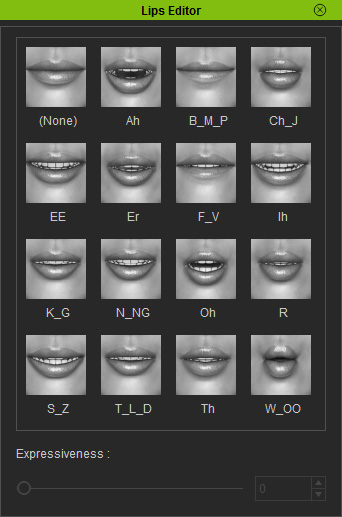

If you wish to add new keys, then double-click on the empty frame cell found inside the track in order to open the Lips Editor panel.
- If you wish to modify existing keys, then double-click on the keys to modify.
You may drag the Expressiveness slider in order to designate the strength of the lip shape.

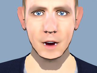

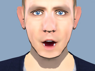

Please note that the results can only be seen after you release the slider.Phoneme: Oh
Expressiveness = 50
Expressiveness = 80
