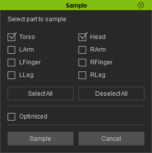

- For Selected Parts:

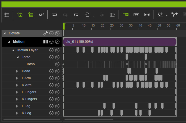

Take a clip shown in the illustration as an example, the sampling methods and results are listed after the image.
- Sample All Parts (Optimized): All body parts will be sampled and the sampled keys will be optimized.
- Sample All Parts without Optimization: All body parts will be sampled and the sampled keys will NOT be optimized.

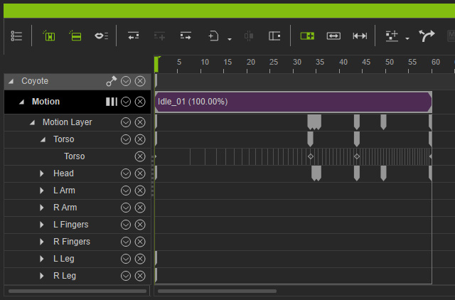

- Sample Selected Parts (Optimized): Only the selected body parts will be sampled. In this case, Head and Torso. And the Optimized checkbox is activated.

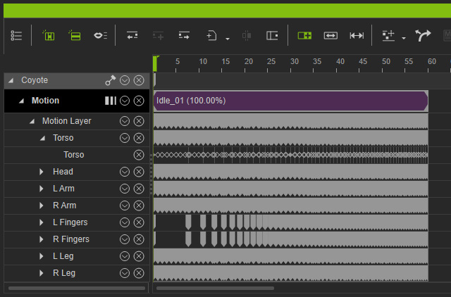

The sampled keys will be optimized. - Sample Selected Parts without Optimization: Only the Selected body parts will be sampled
and the Optimize checkbox is Not activated.
The sampled keys will NOT be optimized.
