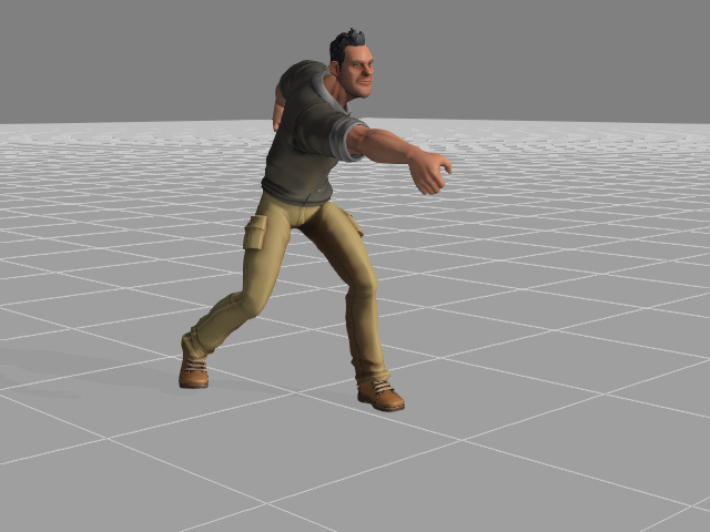

Apply any one motion template (kicking in this example) from the Animation tab >> Motion library to an actor so that the character leaves its original
position. You may also optionally right-click on the character and have the character move away with the Move command.
You may then see the feet of the character slide.

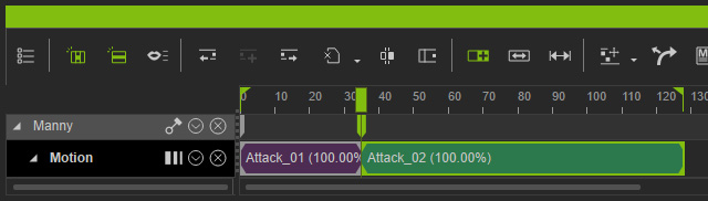

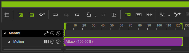

Open the Timeline (Shortcut: F3), then the Motion track of the actor.
You will see that the motion clip is stored inside the track.

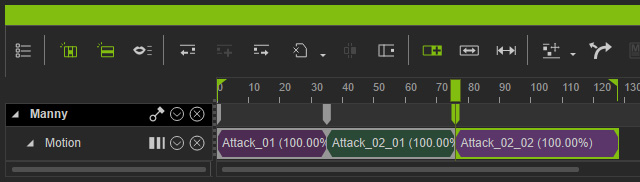

Right-click on the clip where the foot-sliding starts, select the Break
command to split the motion into two clips. The later clip section
now has a foot-sliding issue.

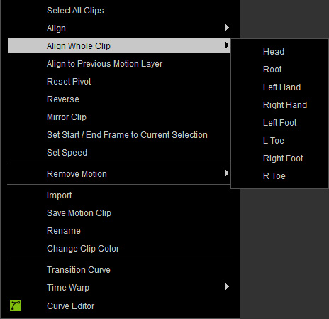

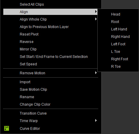

Right-click anywhere on the later clip, then select the Align Whole Clip command and pick one of the
options from the sub-menu. In this case, the Left Foot; which aligns
the entire character body to the left leg for the duration of the clip.
- Repeat the steps by breaking the later clip and align
to the right foot.
The position of the foot will be aligned based on its position at the start of its respective clip.

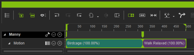

Apply two motion clips.

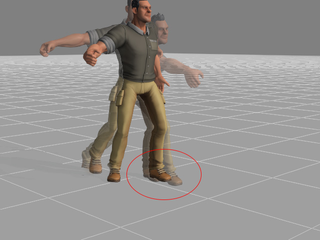

- The character's start position in the later clip shifts from the end of the previous clip.
Right-click anywhere on the latter clip, select the Align command and pick one of the options from its sub-menu. In this case, the Right Leg.
The right leg position in the entire later clip is aligned to the
ending pose of the previous clip in order to remove the sliding issue between these two clips.
