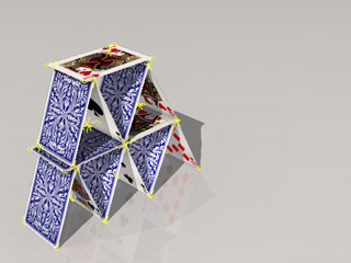

Go to the frame where you want some of the rigid bodies to begin falling. Please ensure the desired objects are selected.
The back stack and the top card are selected.
- Press down the Dynamic button in the Modify >> Physics tab to switch their state to Dynamic.

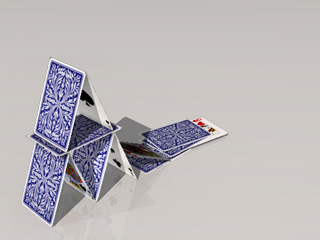

The objects with the changed physics state will fall as soon as the simulation goes to the time frame where you have switched their state.
Only the cards that have the physics state change will begin to fall at the specified time.

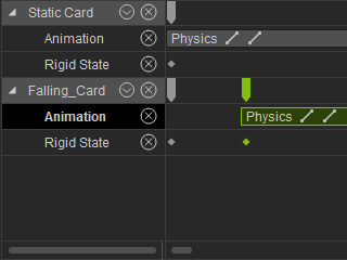

After the simulation stops, select one of the objects that has fallen
and open timeline (Shortcut: F3). Show the Animation and Rigid State tracks of the object. The falling animation
clip should be produced after the Dynamic key.
The simulated clips on the Animation tracks of the objects with and without State Keys.
