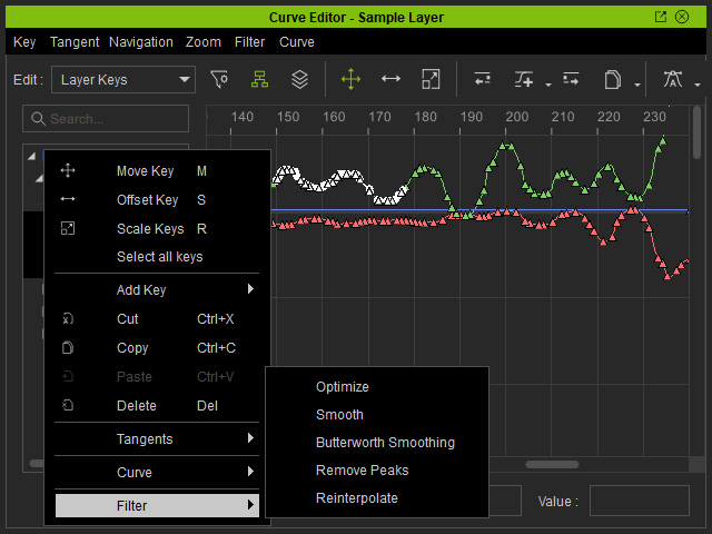

Filter Menu
Note: You can smooth global keys together through the Filter menu. However, you can also apply Filter presets to the curves between selected keys.
The Optimize feature lets you optimize a range of keys while attempting to preserve the overall curve. It is usually applied to densely keyed motion curves to simplify the curve and reduce the number of keys; It is not recommended on curves containing very few keys.
