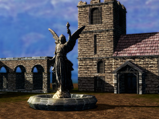

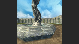

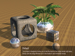

The Changes of Camera View
When the Exporting Panorama feature is turned on, the camera view will be automatically changed to square view in order to be correctly stitched.
The original camera resolution before the Exporting Panorama feature is turned on |
The resolution is automatically changed to square after the Exporting Panorama feature is turned on |

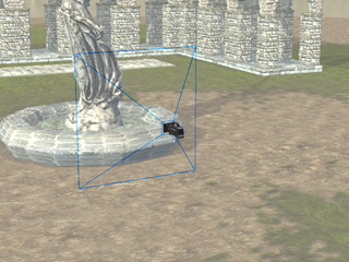

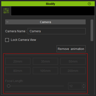

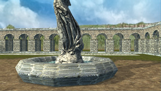

Each of the cameras in the project will be set to Wide-Angle (12 mm focal length) when the Exporting Panorama feature is turned on.
The original camera lens before the Exporting Panorama feature is turned on |
The camera lens is automatically changed to 12mm after the Exporting Panorama feature is turned on |
The value of the camera lens for Panorama Videos is
strict. Therefore, you are not allowed to customize this value

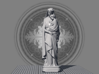

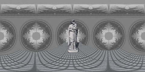

- Repetitive Items: The Image Layer and 2D Background will be
repetitive because each of the
6 camera views renders them before being stitched.

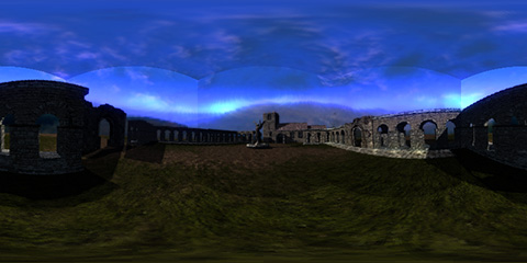

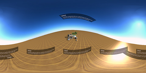

The original project covered with an image layer
The image layer is shown 6 times after the Panorama Video is exported
The original project with a background image
The background image shows repetitively after the Panorama Video is exported

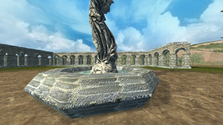

- Seam Issues: If you apply special effects, such as HDR - Tone Map,
HDR - Glare ,
SpeedTree with LOD, Shadows and Toon Shader, the seam where the 6 camera views where stiched will be very obvious (The example below is a project
applied with the HDR-Tone Map).
The original project with HDR - Tone Map turned on
The seams between each camera views are apparent

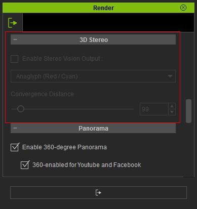

- Exclusive with Stereo Video Output: The Exporting Panorama feature cannot
be applied in collaboration with 3D Stereo output.
