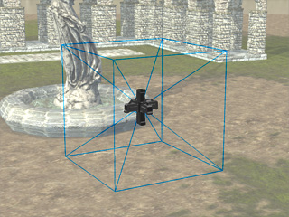

5 more cameras facing different directions will be auto-generated after the Exporting Panorama feature is turned on |

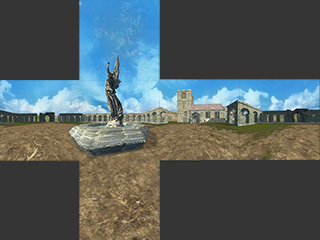

The videos shot from the 6 cameras will thus be stitched in order to form a panorama video with full environment data.
The views shot from the 6 cameras |
The panorama video created by stitching the 6 views |
