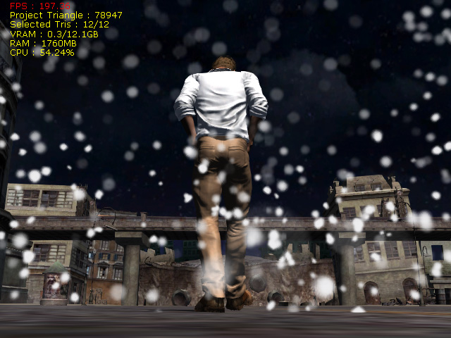

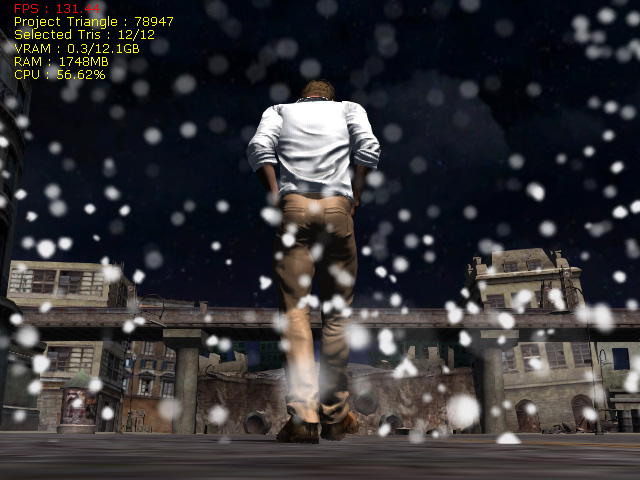

Comparison of Characters in Edit Mode and Lite Mode:
Edit mode: ~131.44 fps. |
Lite mode: ~197.36 fps. |

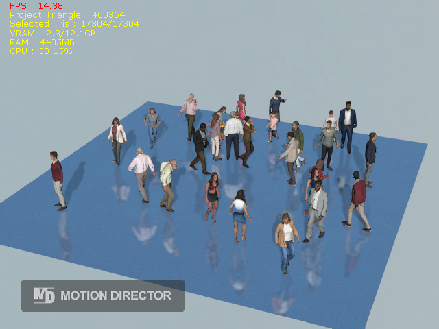

30 actors in Edit mode: ~14.38 fps. |

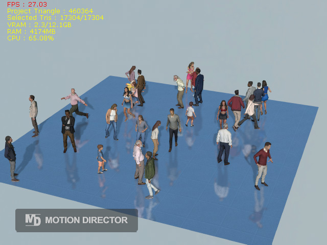

30 actors in Lite mode: ~27.03 fps. |

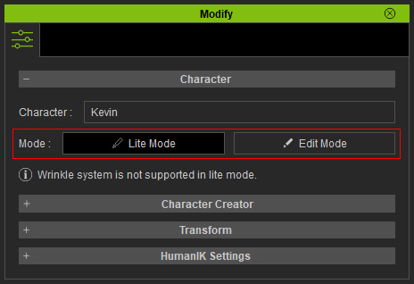

Switching to Lite or Edit Mode for Actors
Select one or more actors, click either Edit Mode or
Lite Mode in the Modify panel.

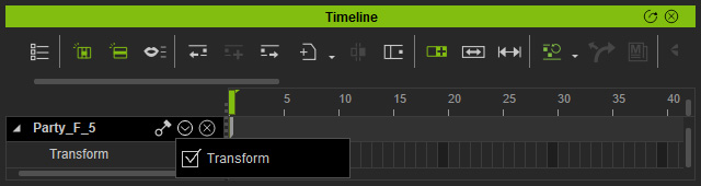

- When in Lite mode, the only feature left for the characters is the Transform settings.
- All the character's animation-related settings or effects will be temporarily flattened and inaccessible in the Lite mode.
- You can only see the Transform track in the timeline.

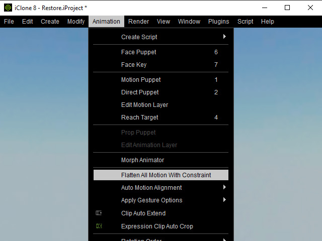

- If the character animations utilize constraints, such as Reach
or Link, then perform Flatten All Motions with Constraint before
converting the character to Lite mode.
