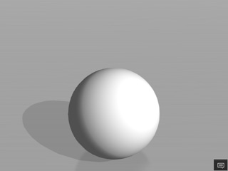

  1. Add a prop into the scene and set some position keys for the prop.

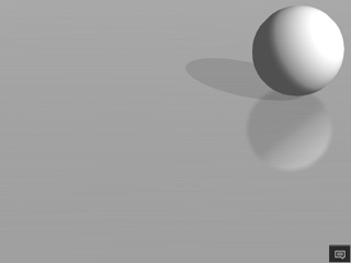

    First Key
    Second Key
    Third Key

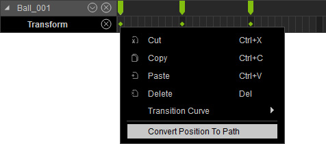

  2. Open up the Timeline and select all the Transform keys of the ball.
  3. Right-click on one of the keys and select Convert Position to Path from the right menu.

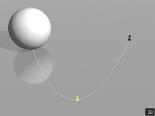

  4. A path will be created for the selected prop.
